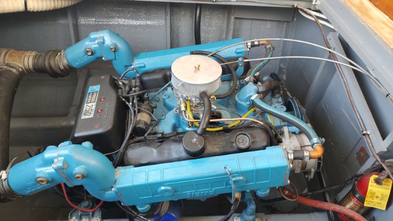

Has anyone updated to the Edelbrock Marine Carbs? If so what was your solution for the hot wire? The Edelbrock info says don't use the coil or alternator.
The engines are Chrysler 360's

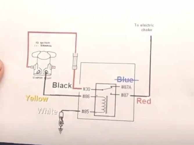

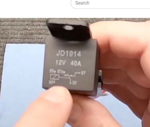

Im thinking of creating a fused relay swith to power the choke from the starter solenoid.
choke relay.JPG (21.26 KiB) Viewed 15555 times
Re: Edelbrock Carb Choke Wiring
It does not show the solenoid wiring, But I believe the terminal you're using to activate the relay goes to the + side of the coil. Full 12 volts cranking, lower voltage running as it feeds from the coil after the ballast resistor. Will the lower voltage keep the relay on? Would the relay draw much less than the choke coil heater? I don't know but I bet it's close.

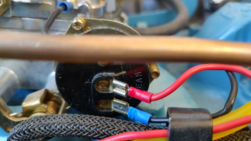

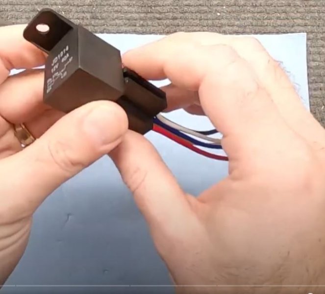

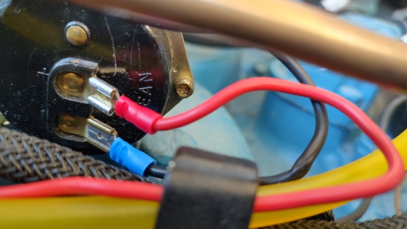

So I built two harnessees based on the photos I attached for the chokes and they worked great !
