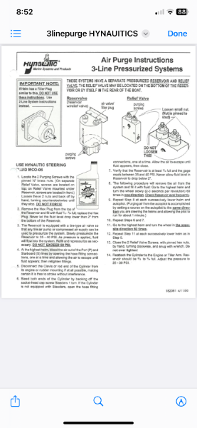

To bleed system fill reservoir with Sea Star steering fluid.
Do not use ATF
Follow direction above and losses purging screws.
Pump up reservoir to 35 pounds.
Turn wheel 60 times to port and then 60 times to starboard.
Close purging screws
Check
Should be hard over to hard over 5 or less turn or 2 1/2 to port and wheel stops and 2 1/2 to starboard and wheel stops. Could be 3 turn each way.
Fill reservoir, check pressure.
In most cases 25 psi is fine.
