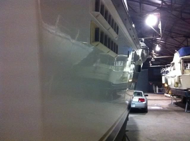

Chalky hull - I just tend to persevere with Meguiar's #44 Colour Restorer (if things get real bad .. used to use that on my dark blue Liberator), or just #45 High Gloss Polish, with a topcoat of Flagship Premium Marine Wax. My hull is 30+ years old (the last 10 under my care), and still looking pretty good! Here is a shot after haulout this year, one coat Polish applied (still need to add the wax). Note the reflection of the other boats in the hull.

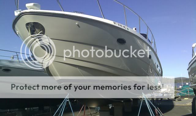

This is why I post the link to the video the buff magic is a compound to get rid of the oxidation chalkyness. You can't put the Rejex over wax not even the 3M restorer wax it is a wax and polish needs to be applied to a stripped gel coat. Check out the video I used to use the 3M restorer also but this works much better and easier.
Not bad for a 96'
