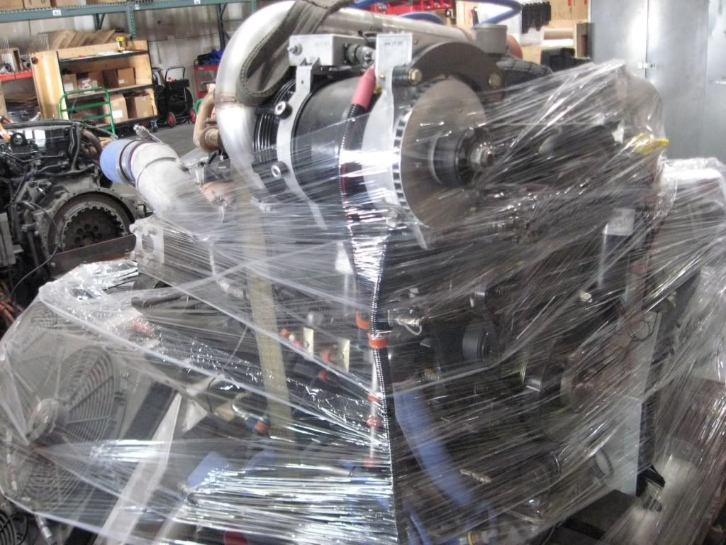

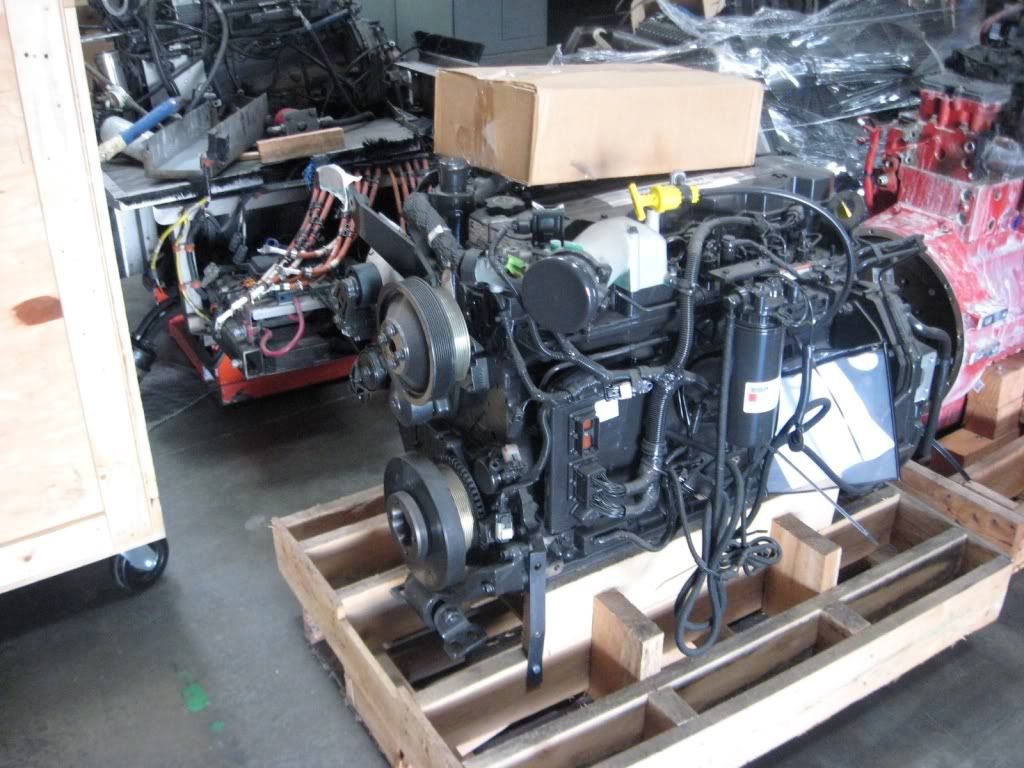

The engines are 2004 ISB 260's. they are essentially the same engine in a Dodge Ram. Electronically controlled, thottle and gauge packages and one has a A/C generator mounted in the serpintine belt line.
Both engines are new and have never been installed, one does have a 60 hour test run on a hybrid drive, my friend said the 60 hours were recorded at about 40 % load.
A friend of mine works for a hybrid bus company that has gone bust and they have two engines in the crate that will be part of the liquidation, he has offered them to me for a song.
I don't think I can justify converting these to marine engines and buying new transmissions plus the installation costs and then to put them in a 1977 F-32, don't get me wrong, I love the boat, but .......
