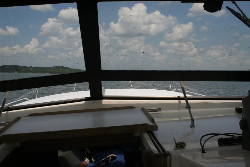

Here is pic of mine. (I hope)
Larry

Someone seasick Larry? I see some feet
Doug

Summer Storm,,,,,yep,,had my son's wife boy on board that day, and he preferred the cabin. :D
