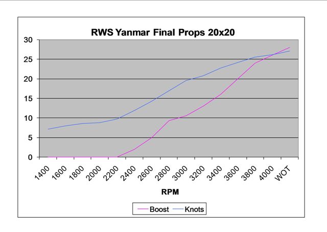

I can't comment on the smaller diesels, but here is the performance chart for my 6 cylinders (if I can figure out how to post it correctly)

I notice you numbers are close to the same 170 hp ( speed vs rpm) I thats why I don't believe there Numbers , I also ran them on Boatdiesels calc. before there a pipe dream .

Thanks for sharing your numbers
