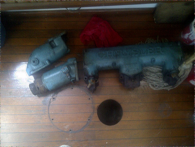

I took elbows off due to lack of room to get to stripped bolt . After taking elbows off was able to wiggle myself in underneath and cut head of bolt . I just found it easier.
- Manifolds apart
- manifolds resized.jpg (112.53 KiB) Viewed 5515 times

thanks for the pics
separating those elbows means you have to have new O rings right?

thanks for the pics
