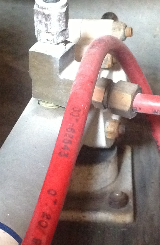

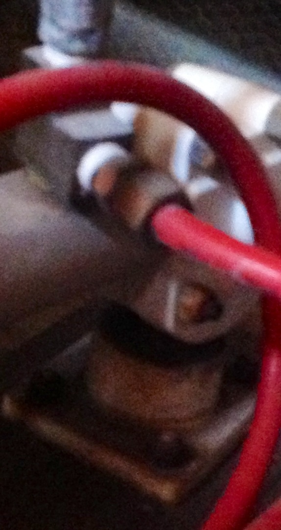

Update----------I checked all the measurements and the toe setting appears to be ok-----while jammed in the lazerette I noticed the steering ram has a good 1" of lateral play.There is a white mount of sorts holding the ram in place that seems worn out---- maybe has a ball and socket??--- will try to get a pic on next visit to send to Bob---

A couple of pics of the offending mount---I know I posted these separately but maybe with a little history would be better-- Mike

A little update--I know Scorpion has the same problem---- I have made some calls around to see what can be done about that worn out mount on the BA125-7-BJ steering cylinder,the bj stands for ball joint, so I will have to wait for haul out and pull the joint out to see if I can make something for it .
According to sea star as they are now called you can replace this unit with an HA5425 mount,or the entire cylinder and mount with BA125-7-ATM( aluminium trunnion mount) I think that would have to be confirmed though and I am also waiting for Beacon Bob to get back to me about the old mount.I really hate to change out something that does not leak a drop, anyway we will have to wait--- Mike

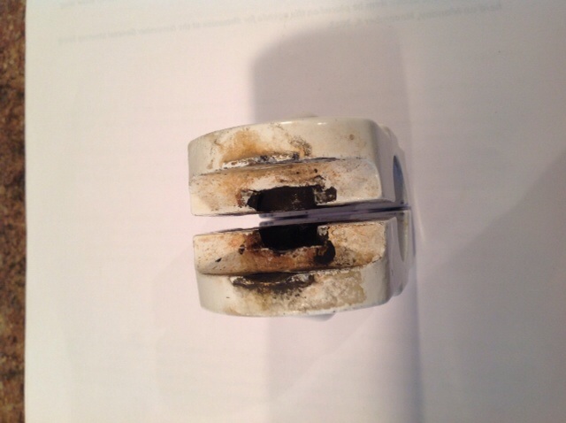

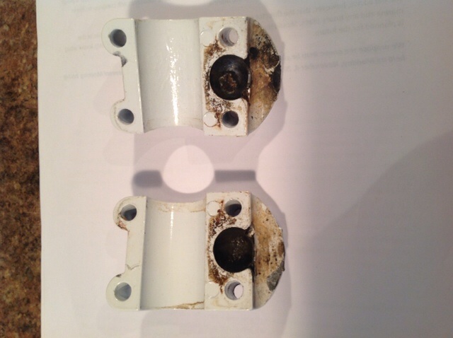

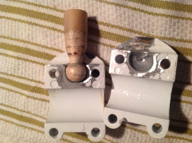

Another update for the steering issues---- this is the offending culprit giving me all the steering slack---- May not look like much but the holes the ball fits in are wallowed out and I think the ball is a bit smaller( have to measure ball yet to get accurate size)----- any ideas out there--- I know I could put a new ram etc down there but nothing leaks a drop at this point and there is auto helm connected as well----- Mike

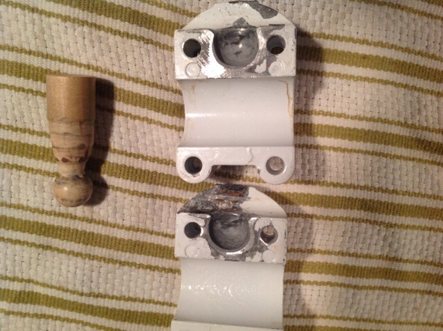

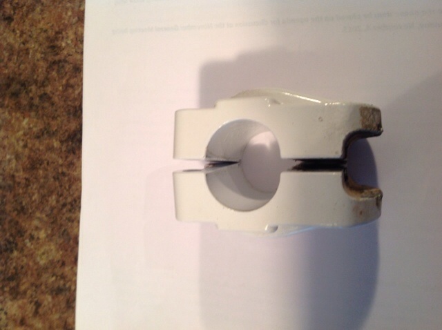

Another update for steering mount---- I made the wooden peg as a guide the same size as the one in the boat about .010" larger at .685 and then epoxied the holes and then fit everything with dremel and round grindstone---- fits now with no slop
