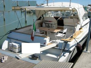

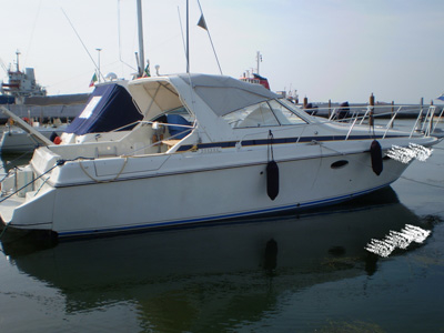

Re: repowering 34 Sport Express

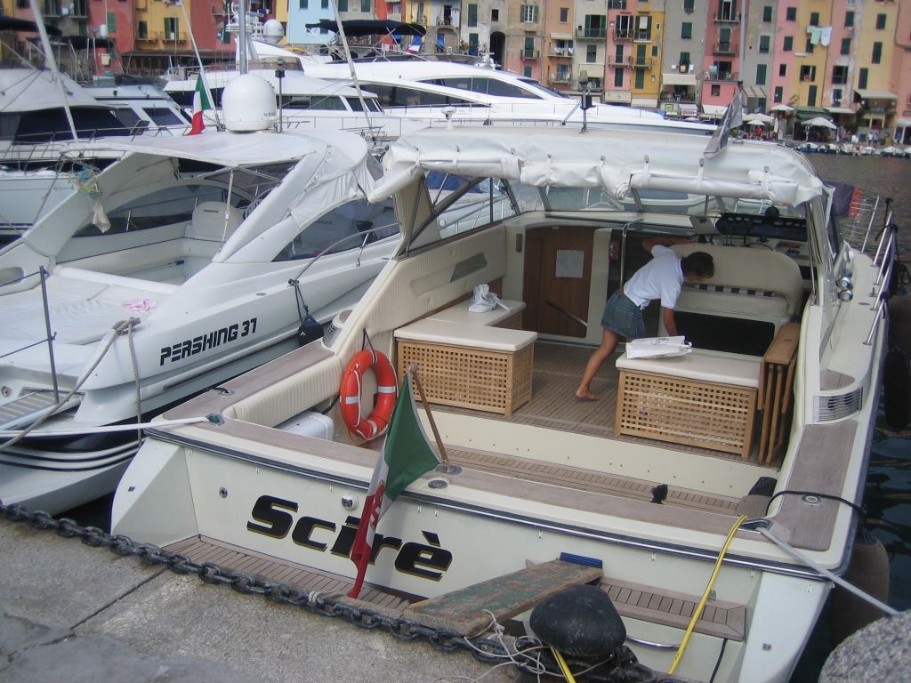

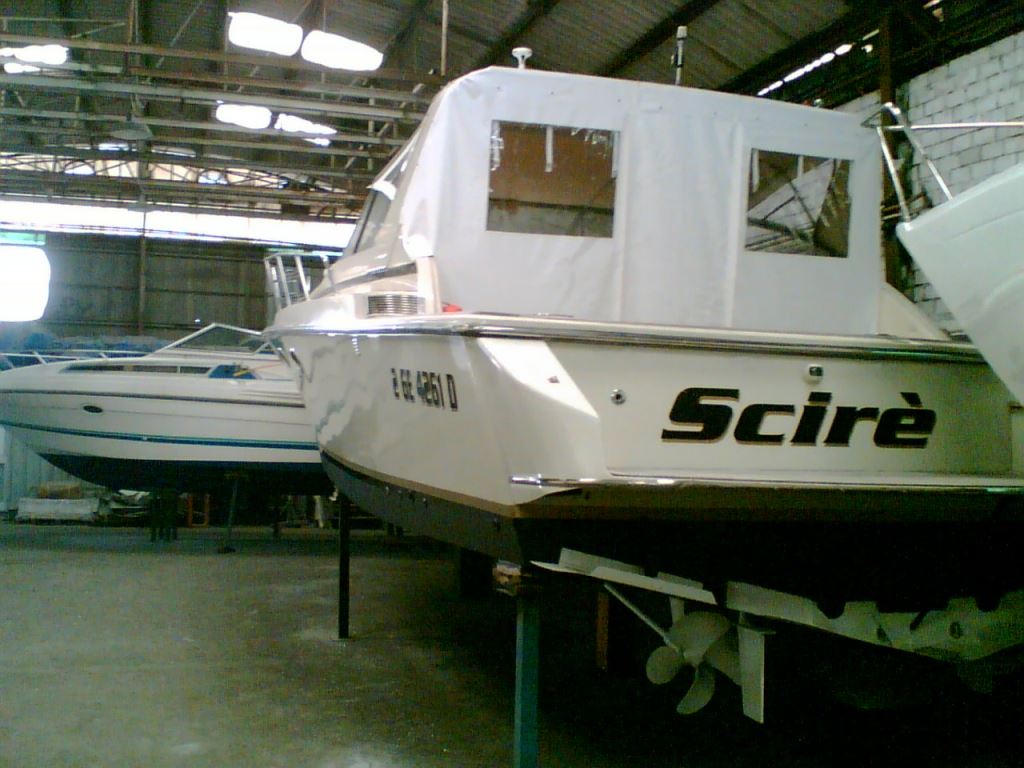

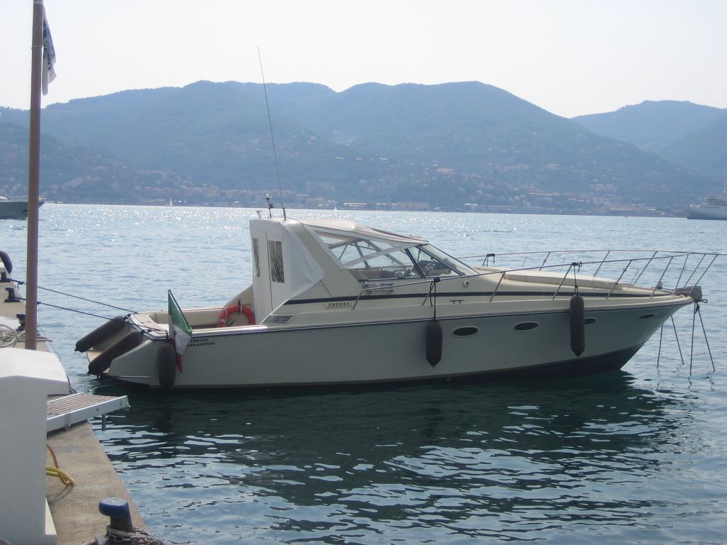

Some photos.
May be it's the boat you call 10 meters. It was build in 1990 when the factory was named Bertram-Trojan (this name appears in all docs I have).
Alberto
that is indeed a 10 meter.

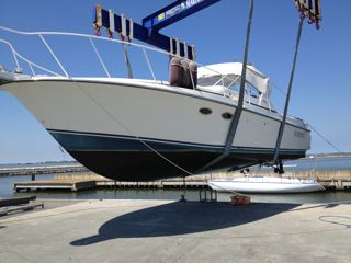

These photos I am posting below might actually be your boat...
second photo attempt
Both are in Italy, however after further examination they are NOT the same boat.
One has a mid cabin style of transom, the other does not.
It's the same boat but there are some little differences. This is normal I think.
Some more photo. As you can see interiors was completely redone in cherry wood.
