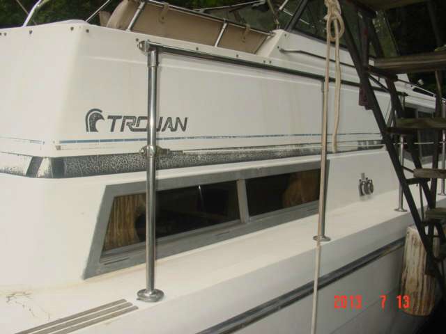

You can check it out here. It has twin 5.7L with a 6.5k ONAN of which I am grossly familiar with from my former Trojan F44. I have a love hate relationship with Onan.
After looking at the pics what do you guys think?
Here are the LARGE cracked areas in the fiberglass
This one here is the one I think that really let the water in under the fiberglass

It's the same old question, buy cheap and put more money into it than a nice one costs or pony up for a nice one. At this point in my life (and I'm not that old, I think?) I won't buy a boat that needs tons of my time and effort. To many surprises and not enough fun time. That being said I still look at these older project boats and vision about what could be.
That boat really doesn't look to bad so I guess my first question is why is it not selling? is it just the decks or is there engine work that needs to be done as well? Did he buy it to flip it (chuckle) or did he find something that makes him want to get rid of it? If was selling a boat I think I would at least put the window back in place.

QUESTION: On that Gunnel or side walk way, how is it made? Is it mostly fiberglass with a center runner of Plywood down the center for core support or does the wood run down into the hull or what? If it's a simple blank of wood cored inside the fiberglass? I don't see that being difficult to re-core and refiberglass.
If there is a lot of wood wrapped around this, that and the other, wrapped in fiberglass, then there is a TON of work that might detour me even more.
If it's a simple board running down the side then that is easy to fix. I can do fiberglass etc.... I'm worried more about having to cut a LOT of glass off and then fixing more than the walk way.
Anyone have any idea's what's all inside the fiberglass? What am I looking at here?

summer storm wrote: If was selling a boat I think I would at least put the window back in place.
HAHA! Yea, I thought the same thing. He DID buy it to sell it. He works for a Marina on the North side of the lake that buys boats at auction mainly from up North. He bought this one personally, outside of the company, but is using the companies web sites to help sell it. It seems that he isn't all that mechanically inclined.
Personally, restoring things like this, cars, ATV's and houses is VERY entertaining to me and I like making something plain into something gorgeous and unique, having other people gush over my work is icing on the cake. My Father is a carpenter for 35 years and I get it honestly.
I don't mind a lot of work, I just don't like an extreme amount of work.....
For instance I spent all last winter fixing up my Carver but was able to enjoy it by summer time and the timing was perfect. A Winter, to do the work is a lot of work, 2 or 3 winters is and extreme amount of work.
I think mechanically it is sound with a good tune up and change of all the fluids. Both engines run smooth and rev well but are just hard to start. Probably need the carbs cleaned and adjusted. The Onan purrrrrs like a kitten. Matter of fact I have never seen one runs so smooth. The Genset has something like 800-900 hrs on it, the motors have 500 hrs on them. They are 5.7L Chevy engines. Very easy to work on and maintain. That is NICE to me that they are in good shape.
My big concern is getting everything else re-done and gorgeous and then having a HUGE hole that I have to cut into the side of the boat and then getting in there and finding that I have to keep cutting more and more out because it wicked all over the starboard side......
I'm concerned about the wood around the windows as well by the looks of the fabric and teak on the inside of the Salon. Makes me wonder.
