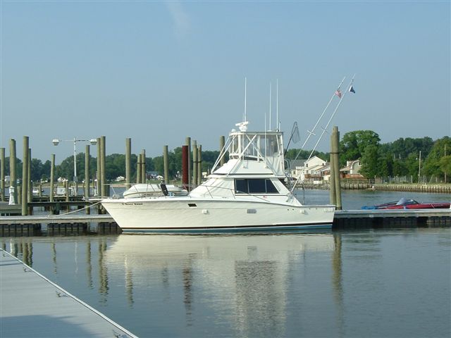

Re: f-36 crane
I carry a 9 - 9.5 ft rib on my bow (140 lbs) . That's about as big as I would go . I use a small crane I put the engine first and keep it on the stern deck . To have a crane That would lift 600 lbs you will need to have the crane post go throught the deck and run into the boat . Not easy to hide
Re: f-36 crane
You Can see it in this pic
I agree on watching the weight on the bow . IF you have stern tanks use them last
- at CB.jpg (51.64 KiB) Viewed 6364 times
