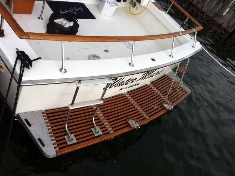

I redid mine a few years ago and went with Cetol (regular, not Lite). If your platform is the same design as mine, it can be a bugger to take apart (board by board), and get them all back in place again. Doing so makes it a lot easier to strip and sand each plank, and refinish them all before reassembly, but a LOT of screws and hidden screws to deal with. Whatever you decide to use, don't use anything slippery... varnish is a bad idea, as is Cetol Gloss.

captainmaniac wrote:I redid mine a few years ago and went with Cetol (regular, not Lite). If your platform is the same design as mine, it can be a bugger to take apart (board by board), and get them all back in place again. Doing so makes it a lot easier to strip and sand each plank, and refinish them all before reassembly, but a LOT of screws and hidden screws to deal with. Whatever you decide to use, don't use anything slippery... varnish is a bad idea, as is Cetol Gloss.
+1 and nice rail as well there Captain. That's a clean looking boat.
I did my platform the same way and it was allot of work but well worth the results. The aluminum castings on mine were looking a little dull and didn't do the refinished wood any justice. To remedy that I had them powder coated white.
I'm happy with the way it turned out.

That powder coating looks good, Paul. Like Paul and the Captain, I used "Regular" Cetol. Not "Gloss" and not "Light". I removed the swim platform and sanded the top surface with varying grits of sandpaper. I did not disassemble the individual teak strips. There wasn't any real build-up of any previous finish in-between my strips and so I simply applied the cetol and it worked out to my satisfaction. I have not have good results with Cetol when I used a foam or sub-standard brush. I always buy a new horsehide brush each spring.
After sanding, I applied four coats of cetol and that seemed to be enough. Over the past seven years, I have applied one new coat of Cetol every spring and this process has seemed to work well with no apparent need to re-sand the platform due to wear or sun fading. Hope this helps.ImageImage
