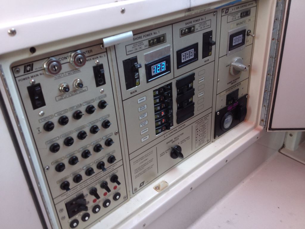

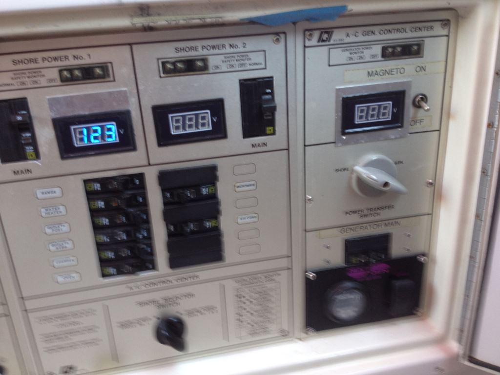

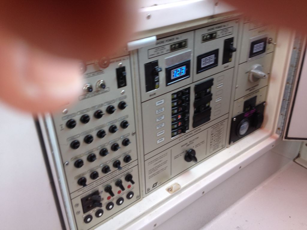

Here are the photos of my conversion to digital last year instead of the more costly analog.
- IMG_5699.JPG (80.76 KiB) Viewed 7373 times
- IMG_5700.JPG (94.73 KiB) Viewed 7373 times
- IMG_5701.JPG (82.24 KiB) Viewed 7373 times
