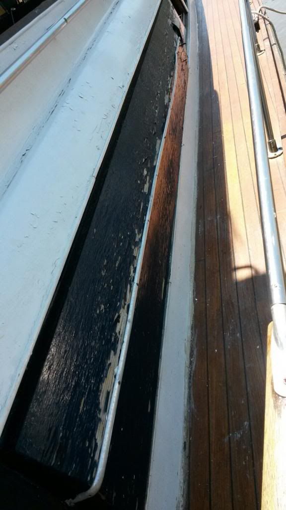

And so the sanding begins.... What type/brand top paint would you use that could take the beating of the sun & weather fairly well? Is a primer or topcoat sealer recommended? Again, first boat, first restoration, thanks for all the advice!!!

How much work do you want to put into it?!!
This is what I do; strip to bare wood. refasten all the joints and open them up. Wet them out with epoxy and fill with thickened epoxy. If you don't do this, the paint will simply crack at the joints very quickly. If you really want to ensure no cracks at joints, sand out a four inch section of the joint (2" both sides) deep enough to epoxy in a strip of glass over the joint. Coat all surfaces with epoxy (West), sand, fair, sand, fair, sand,fair.....paint with Interlux Perfection two part polyurethane paint. Not the easiest paint to work with but beautiful results, and you won't be painting again for a long time.
Or simply sand off loose paint and recoat with a good quality one part paint.

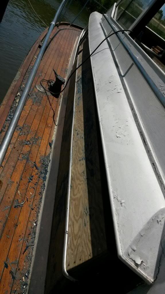

I agree there are varying opinions on the use of epoxy on wood. IMO, when done and used properly, epoxy is a wooden boat's best friend for many areas. I love wood but I embrace using newer technologies to achieve certain goals. I fall under the category that the common saying "wood needs to breathe" is a myth (yes I just said that). While there are things to consider, I see nothing wrong with coating one side, it'll breathe through the other if that's the concern. The thing to remember is that the coated side will be more stable than the other, this is an important consideration sometimes. And what happens when you completely encapsulate a piece of wood? it can't breathe, but it will never rot either. I've removed a lot of vinyl on wooden cabin tops and bridges over the years, wetted out with epoxy and laid glass, faired, then painted. I've also completely coated and glassed the side sections shown in the pictures above, you'de think they were fiberglass after I was done. No more worries about rot, no cracking, and they still look great with no issues due to suffocation :wink: Now glassing a hull, that's a different story!
