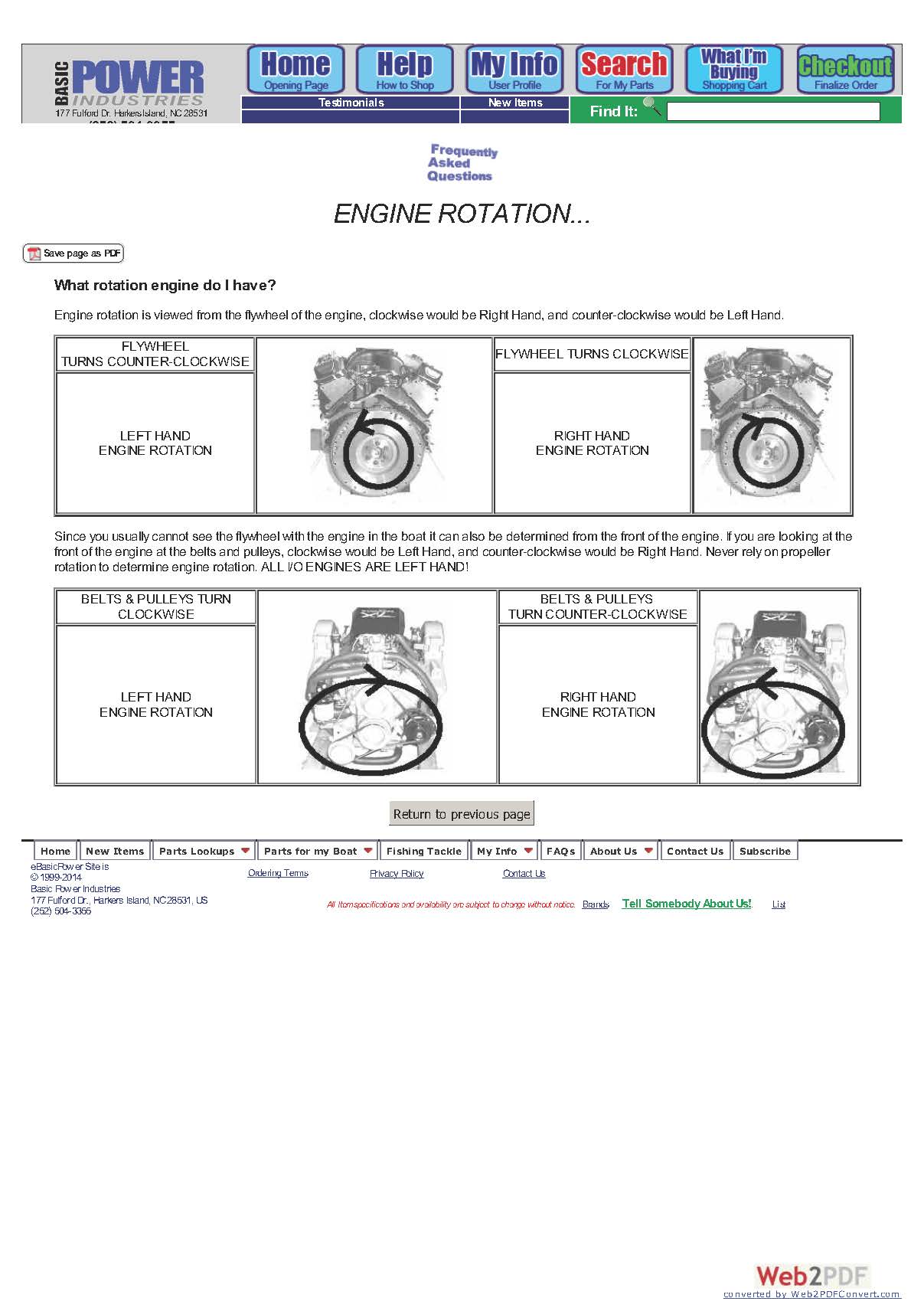

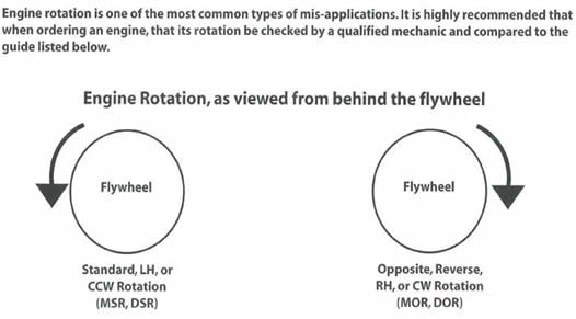

I already hate myself for even mentioning engine rotation, but, I have been looking for the chart that has been posted on this board that indicates engine rotation and starter mounting and rotation. Did a search and could not find it. Can someone post it or point me to it? I have no rotation questions but would like to print the chart.

What I have

Thanks, I got it, my son needs to get it. LOL
engine rotation chart.jpg (172.53 KiB) Viewed 3899 times
