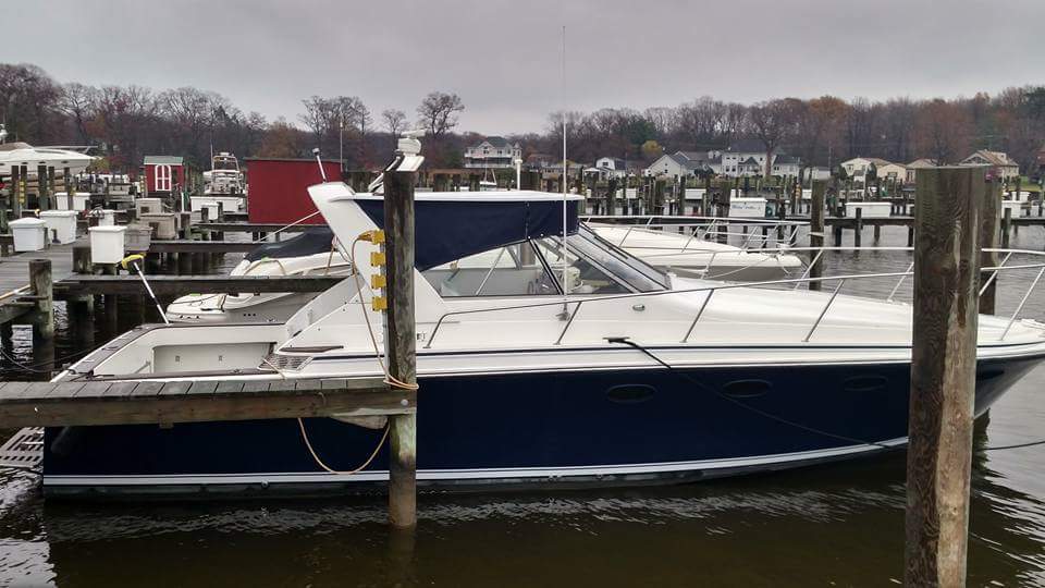

Hello all,
I am in the process of buying an 82 Trojan 10 meter express. It has had some work done and is a pretty fair price I think. I have a couple of questions hopefully someone can help with? I put a deposit on the boat and will pick it up this weekend.
1. Under the front birth, there is a storage locker. I noticed that the floor to this locker is a piece of plywood that is rotting. The owner says his surveyer told him that it is non structural and not to worry about it. fix it if you want. Anybody have any experience with this? I know I will need to make sure wherever the water is coming from needs to be fixed, I am more concerned about if this is anything to worry about?
2. I am under the impression that these boat are mostly fiberglass under the water line including the stringers from posts online. Is this correct? Well with the exception of at least the bulk head behind the engines. This bulkhead does have standing water against it and does not look rotten but im sure its got some moisture in it. I plan to be more vigilant that the current owner at keeping water out of the bilge. He likes to kill power to the bilges due to oil leak and not wanting it to contaminate the "clean marina". Should I be very concerned about this bulk head? The floor seems pretty solid.
Thanks for any input! If you think of anything else major I should be looking at please let me know!

Your stringers do not have wood in them, they are solid fibreglass. Water can get under the forward berth from several places. 1). The anchor locker is at the head of the berth, check to make sure the drain hole from the locker is clear. check the bottom of the chain locker for cracks that could allow water to exit the locker.
2). My railing stancions were leaking and allowing water to enter the forward berth area and under the mattress.
3). There are also cleats that could be leaking.
My rear lazarette behind the engine bulkhead always has some what I will call mystery water. I have no idea where it comes from, however it will work it's way under that bulkhead and end up in the engine room bilge.
As for the oil leak, my Port engine leaks some oil from somewhere, I have placed absorbant mats and aluminum roasting pans under the engine that catches it.
You will love this boat!!! Congrats if your purchase goes through.

If the area in question is under the mattress in the forward berth, yes - not structural.
That said, the question of the rotted wood is WHAT CAUSED THIS ?
It is important to track down the CAUSE to stop further and continuing damage.
The pre mid cabin 10 Meter International series of boats has very little structural wood below the deck.
The stringers are hollow - no wood and the hull is solid.
There are however five pieces of wood below the deck that I am aware of:
1. yes, the bulkhead between the engine room and lazarette is in fact wood.
this would be difficult to replace. I fish-plated mine with STARBOARD and then added extra sound insulation over top
2. there are two pieces of plywood running vertically in the corners between the sides of the hull and that bulkhead at the stainless steel air intake vents. I do not believe these to be structural
3. A pair of 1"x3" strips of wood about 2-3' long running fore/aft just below the fixed part of the aft deck. They are in the area beneath where the removable deck step touches the deck. These are simply stiffeners, and are attached with thru bolts. When I had my fuel tank out, I replaced mine with tubuar aluminum and a bead of 5200.
As compared to the mid cabin based boats, yours has a full liner and uses very little wood throughout. You will also come to enjoy several unique features left out of the later production mid cabin series, including the overhead HVAC vent system.
I do hope you had a professional survey done on this boat before purchase.
Best of luck, and enjoy your 10 Meter.
