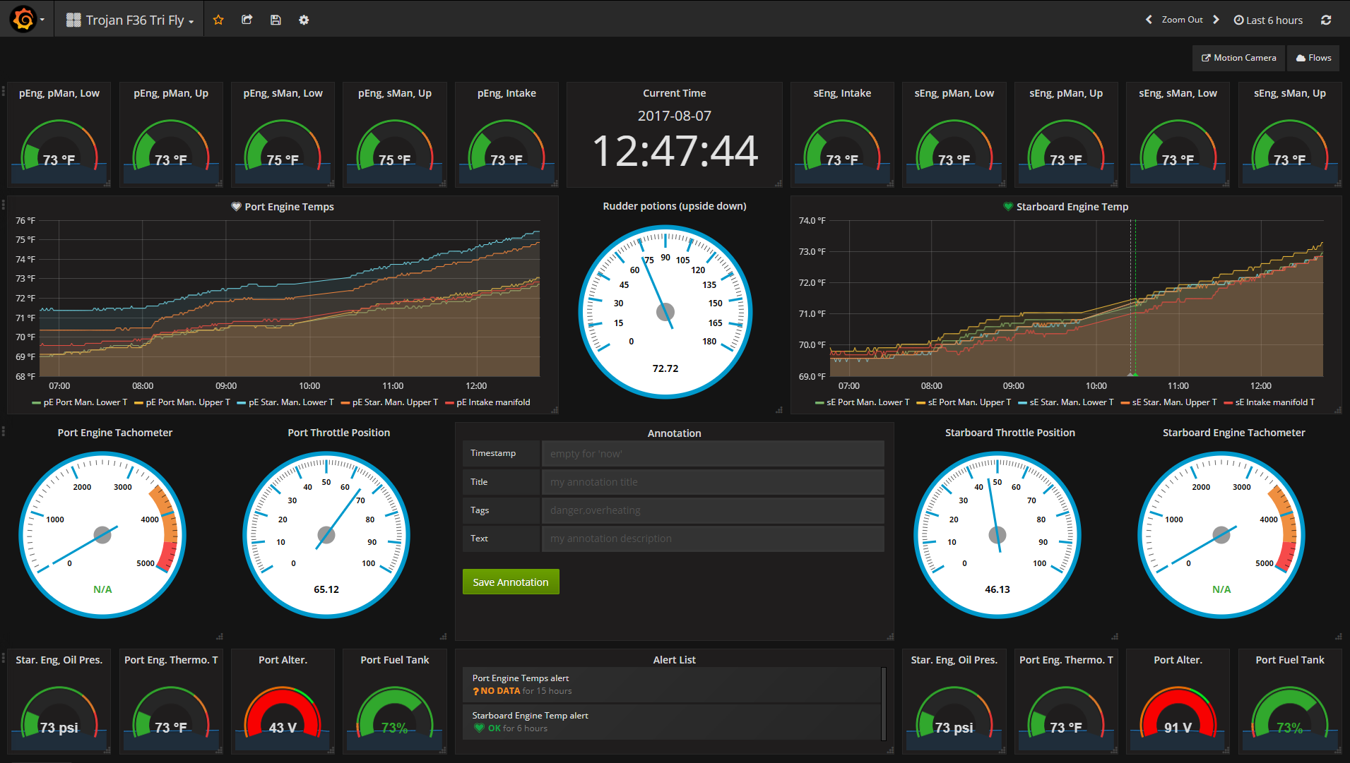

Hi Guys,
Just heading to the boat to install the system. Attached is the Dash on my PC. I will send more info once i get it installed on the boat latter today. Ive made lots of progress of the boat and will update the thread with the build process once this part is running.
- 1080p dash all temps real data, test data for RS11
- healthyvessel-f36.png (229.91 KiB) Viewed 20790 times

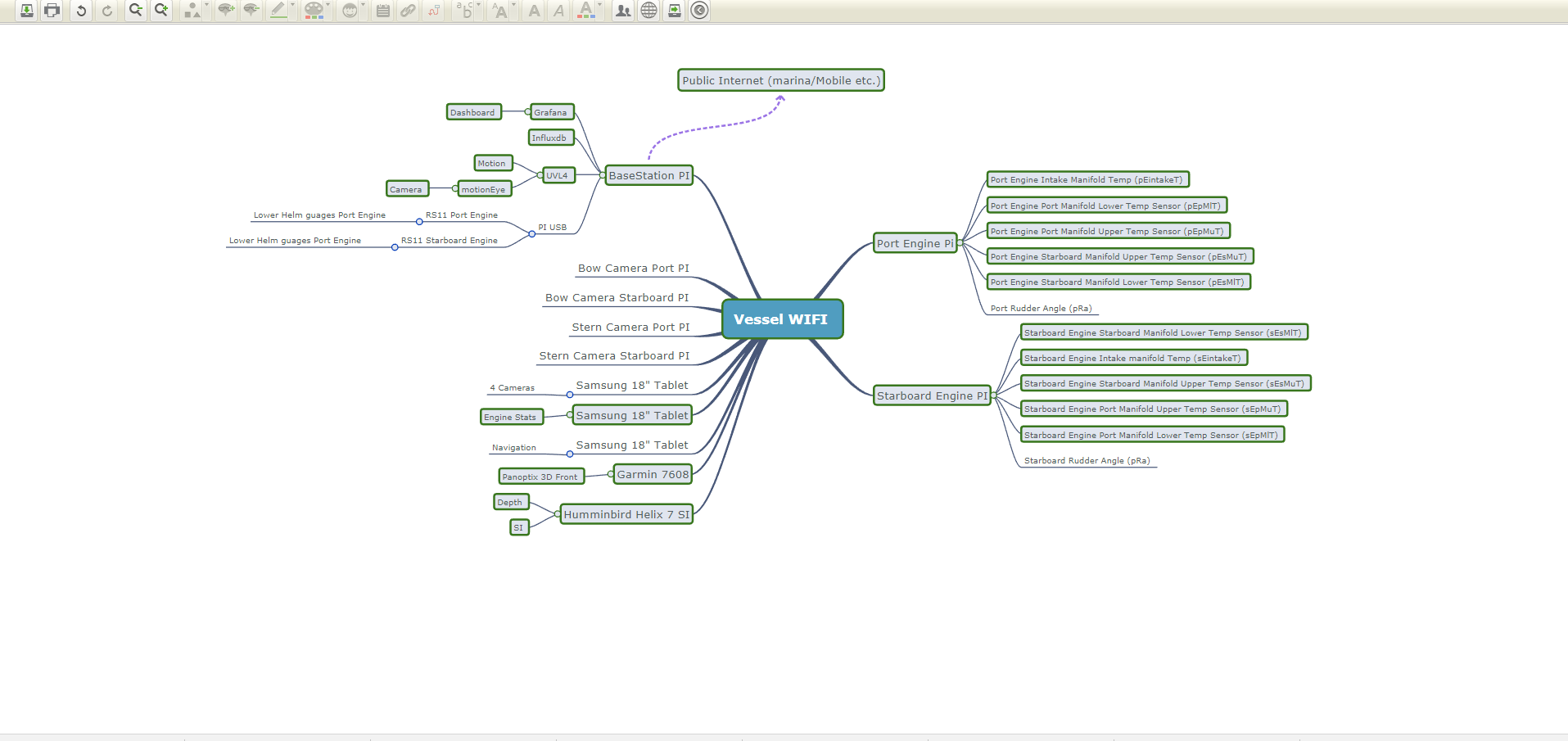

Re: Digital Dash and automation on Trojan F36 tri-fly
Attached is the overall architecture.
Completed items are in Green.
- completed items in green
- healthyVessel-mm-overview-arch.png (76.04 KiB) Viewed 20785 times
I noticed your showing cameras in structure and a connection to public wifi. Are you planning on viewing these while away from the boat. I was using ip cameras till my marina went to a public wifi system and have found no open ports for incoming connection as would be the norm on that wifi. So I was curious if using a raspberry or a work around you knew you might share. Even without that I am very interested in your work here as I have some sensors etc on my lowrance hds nmea2000 network but would love to see this work. please keep us in the loop
