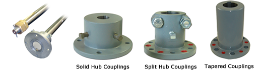

The square head bolts are the norm in the shaft coupler . The they are normally safety wired to keep from coming lose . first the shaft should be a very tight fit into the coupler almost a press fit , if not its most likely worn . The shaft could be worn also . Make sure you get the shaft in all the way in the coupler . The fact that the starboard side has hex bolts and lock nuts makes me believe it also had issues . While you maybe able to get by with you fix New couplers may be needed . If you replace them I would go with the split type . cost more but hold the shaft better ( that's what I have ) One other thing NO SS Bolts !

Thanks for the reply Prowler I think I will get the split couplings to be on the safe side. It looks like that would be easier to insert the shaft and make sure it is all the way in, then crank it down tight. When we inserted the shaft the last time it definitely was not close to a press fit.

I replaced the old coupler with a new split type coupler and there was a huge difference in the fit. The old coupler was quite worn and would slip on and off with ease, while getting the new one on was quite a chore. I finally got the shaft and coupler lined up perfectly and it took several blows with a hammer in the confined space to get it all the way on. Then I used Blue Loctite on the bolts and an impact to make sure it was tight. I painted both shafts where they enter the coupling with a little white paint so I can monitor them for slippage.
