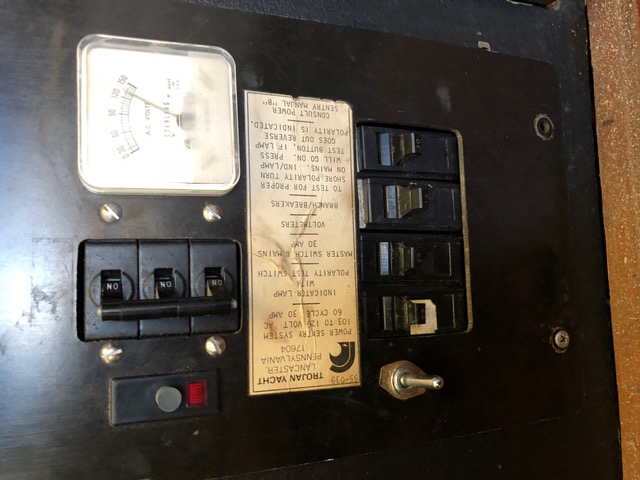

Trying to figure out what each of these 4 breakers are for .
The first one 15 amp is for my Battery Charger next to chrome Genie start switch
Any info on the next 3 would be awesome they are 15 Amp 15 Amp 15 Amp 30 Amp
Thanks
Mike A

Turn not them off one at a time and see what is not working . Do you have a Shore-Off-Gen switch ? Its kind of odd to have a 30amp breaker and a 30amp Main . My F30 had a 30 amp main and only 2 15 amp breakers . I had no genset or water heater . Do you have a water heater ? I half to wonder if the single 30 maybe for the genset . I don't believe its factory Trojan

I do have a Gen set and a water heater and the shore power off Gen set switch
the boats winterized i'll try the water heater and GEN set n a few months when things thaw out
thanks for the reply :)
Re: 1974 F32 110V Breakers
My guess is the 30 is the stove,one branch probably includes the charger,one more branch,one for the water heater and thats four.In all these years though, someone will have been in there, you really have no way of telling until you do the detective work.Do you have the electric heaters as well ? Please be careful when checking , like I said you never know how things have been wired, its not like a house.
My stove/oven is 20 amp I believe (could be 15) FWIW . I for got to ask how may Shore power cords are you sert up for ? If 2 is that the only panel ? Some early F36s had 2 pannels not sure on the F32 .

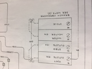

Breakers are should be right to left or left to right.
1.Stove
2.Water heater
3. Starboard outlets
4. Port outlets
We have the electrical drawing for your F-32 just give us a call. 609 713 4602
Note: Trojan electrical drawing are specific to a Trojan Boats hull number. Depending on what X package were purchased or options can change the electrical drawing.
