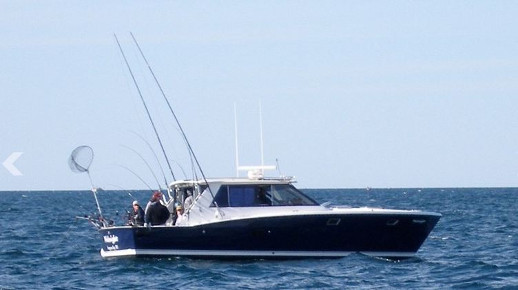

I would plan to build a platform for the steering station and I’m also quite tall at 6’5” so I guess I’m double covered
As for the investment, I agree this will be somewhat expensive however the majority of the money is the engines themselves which I can unbolt and sell if it all goes horribly wrong. As for the reinforcements, that part is cheap it’s just marine plywood epoxy and glass. Oh, and time. Lots of time.
I would love to buy a ready to run boat that has what I’m building, but please find me a 36’ hardtop pilothouse yacht with lines as nice as the Trojan 36 with new or less than 5 year old engines and running gear on it. The closest things are a Sabre 42 salon express, a mainship pilot sedan 34, or a hinckley picnic boat 40. Now notice all those boats are 300k used. I attached a photo of F36 midnight. Look at that thing. I mean c’mon!
Ultimately though, it will never make financial sense but I’m doing it because it will be fun. I’m building a composite epoxy boat from scratch right now. I designed it myself using naval architecture software and a calculator. I’m almost done so I need a new project!
