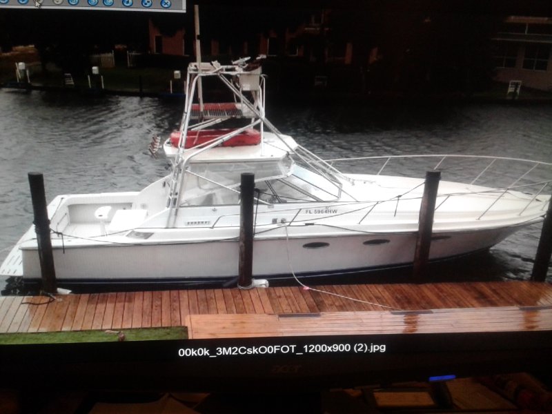

Boat is a 1986 Trojan 10 meter express with tower and twin Cummins. Knew from reading forum it was a boat that got rain water in the bilge, but haven't had rain for most of the month and still have water. We turned off bilge pumps and noted water buildup in the bow area with it really noticeable at the foot of the stairs. Boat was sinking bow down. Looked in the easy to get to bilge areas af around the engines, and shafts,
10 meter001.jpg (73.21 KiB) Viewed 11134 times
t but even that area aft of the generator and the fuel tank is covered up to some extent. A bilge pump aft of the generator appears to have been place in a cut out hole on the bilge floor there and is set down about 2 inches. The bilge pump at the foot of the stairs gets the water first. Any suggestions about how to go about finding the leak would be appreciated.
