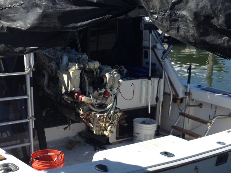

On mine (F36 ) Remove a metal tap on the top of the door and lift the door and pull out . The engine will come out the door way .No need to remove the other glass We used a fork lift .come in at angle . Angle the boat to lift if in the water . I will try and get a photo of the tab , on some you need to remove part of the lower track . All pretty easy . Photo of mine coming out

In my case we used the fork lift and tilted the fork down close to the engine . Lifted it and slowly back up the fork lift . Putting it back in it was low tide and we move the boat to the engine and thru the door . Pulling it out (Fully un hooked) took about 5 minuets . Just myself and The fork lift operator . Putting it back in took 2 more people to move the boat as needed maybe 15 minutes ? I have done the same with a boom truck .
The fork lift used it the type used to lift boats out of the water . Out of the water would have been easier ( with a fork lift) , but I had just haul out the week before she blew up.
Pulling off your exhaust manifolds would make it easier getting out the door .
How you do it varies on what equipment you or the marina has .

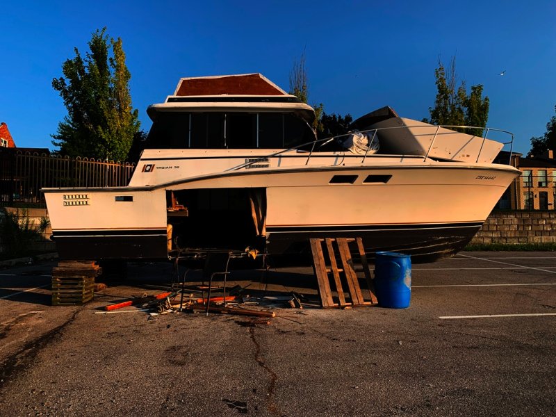

There's also this approach to pulling an engine..... but I can't say I recommend it!
Re: F32 patio glass removal
Ouch . Believe it or not that the way its done on some boats , Seen some tugs done that way .

Abandoned by owner. Sold off by marina owner for non-payment of storage fees. Parted out by opportunistic person who took sawz-all to hull to pull engines, fuel tanks, water tank rudders, props and struts, bridge console, railings, navigation lights, etc... Literally, he used a sawz-all to cut around every potentially useful component or fitting or hull section that complicated access to pull everything off. Where every cleat, fairlead, stanchion base, and primary through-hull was, turned into a 6" x 12" hole. But on the plus side for the wrenchers out there... no wrenches or screw drivers were damaged or dirtied in the process!
But having said all that, I do have some other interesting shots showing thickness of the hull layup in the area he cut out. Didn't have calipers or a measuring tape with me but do have shots of hull thickness compared to width of a key...... will post in a new thread if there is sufficient interest.
Hulls are not as thick as most would think
