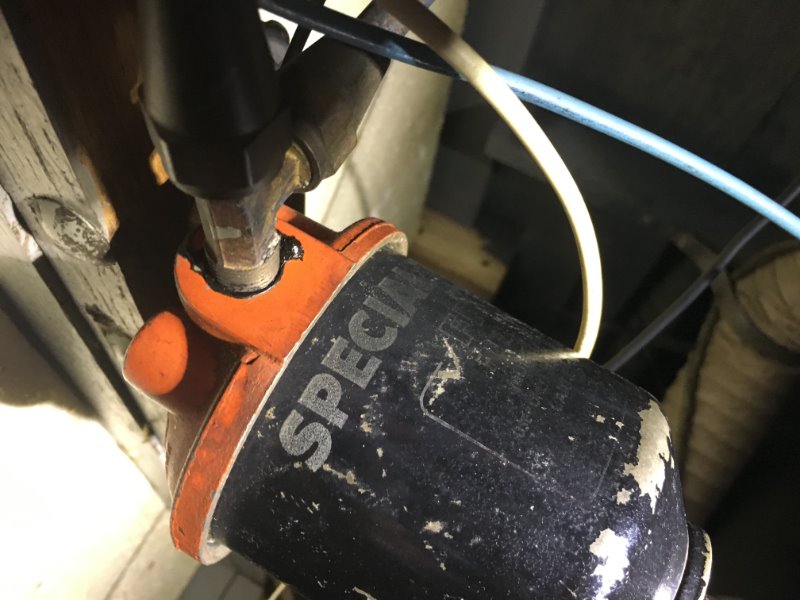

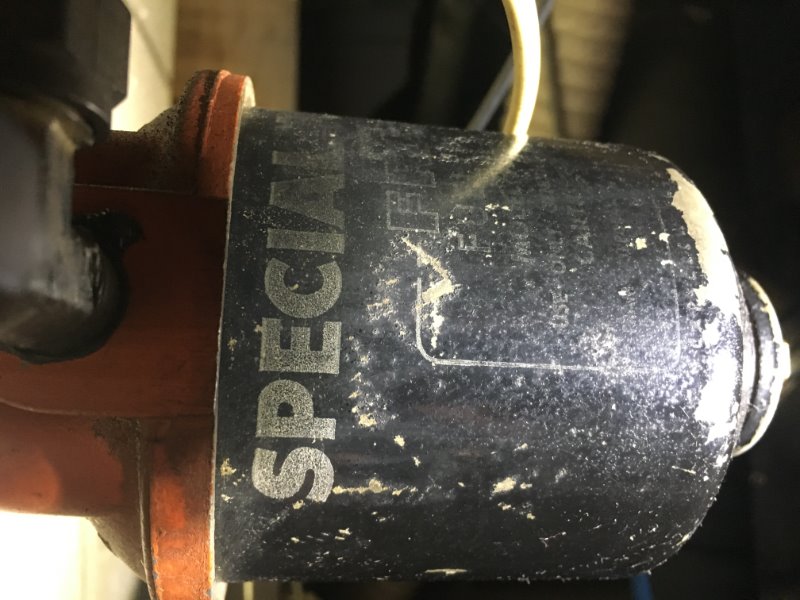

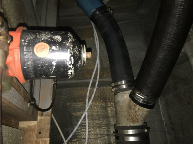

I would like to replace the original fuel water separators on my 1978 F30 with twin 318's. Which brands and models would you recommend, and is this a DIY project? They are currently plumbed with copper, would replacements mean reworking the copper, or going to gas hose. Thanks for any help and advice, especially from anyone who has already done this.

What's wrong with the original fuel/water separators? They have a drain plug in the bottom to drain the water, they are approved for the engine bay and the filters are like 20 bucks. The copper lines are the safest lines you could have in your boat in my opinion.
Re: fuel water separators
Nothing wrong with the original filter. If you're using blended fuel though, I would keep a close eye on the condition of the inside of the bowl, it's likely to corrode in ethanol blended fuels. That's one of the pros of the throwaway spin-ons, you don't have to worry about that particular piece of hardware in the fuel delivery system. Copper lines are great but again with today's blended fuels there are concerns with corrosion for any metal in the system that wasn't specifically designed to operate in an alcohol environment. That's why regular plumbing antifreeze will warn you not to use it in metal pipes and is why you shouldn't use it to winterize your engines or anything else IMO, it should be the stuff that is specifically designed for both as it has way less alcohol but that's another topic/thread.
dagen wrote: Mon Oct 21, 2019 4:22 pm....They are currently plumbed with copper, would replacements mean reworking the copper, or going to gas hose......
Nothing special about the new housings, you should be able to use your current hardware and pipe. Hopefully the fittings in your current filter housings will fit the new ones. If they don't, they're not that hard to find.
