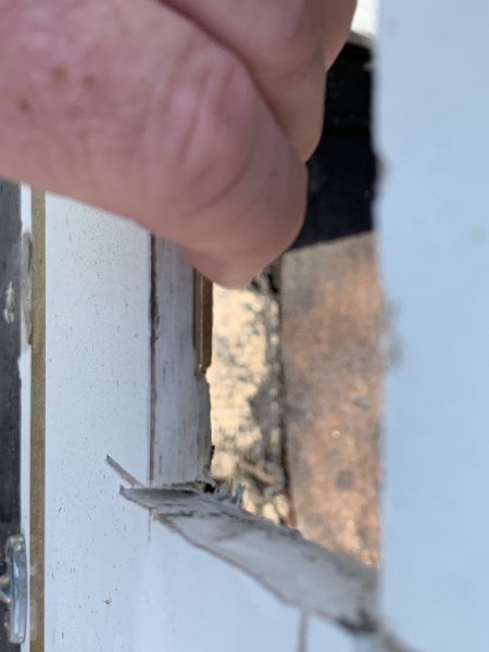

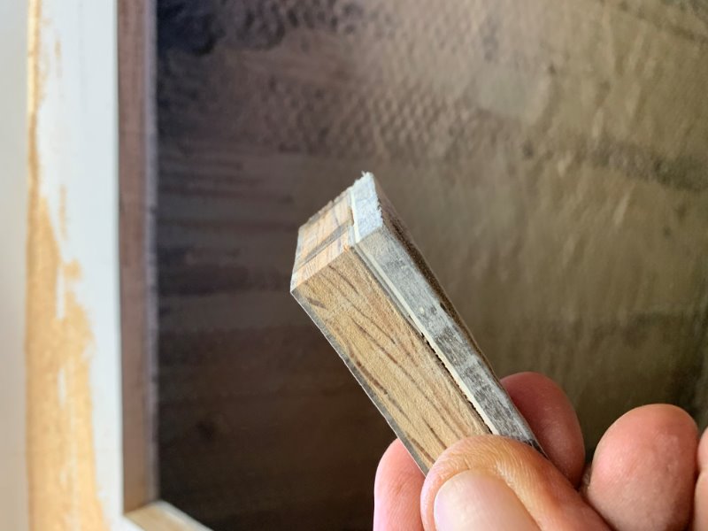

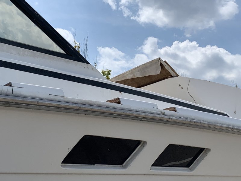

Railings were cut off the boat by sawz-alling around the stanchion bases. You can get an idea of the toe rail coring / glassing from this shot. Those of you with an existing Trojan "SLING" sticker can get an idea of plywood core vs glass thickness.

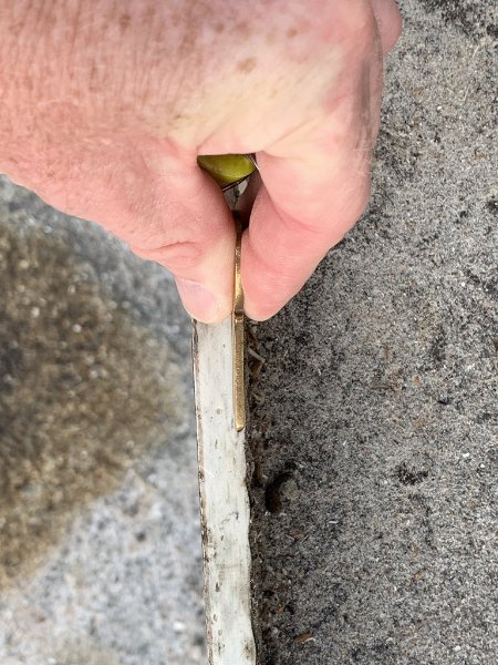

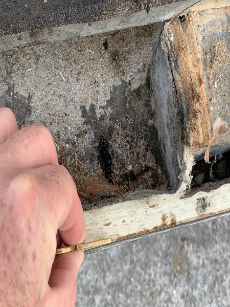

This shot is of the hull side near the chine, and likely a sign of bottom thickness. Took this shot facing straight down on a section of hull side where it was cut off maybe 4" from the actual chine. My guesstimate is its about 9/32 - more than a quarter inch. SOLID GLASS.

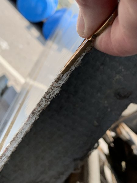

This shot is hull side a few feet up from the chine. Not the best shot, and not the best light, but would say hull side is more than twice the width of the key.... so 1/8" to 3/16. Again solid glass, not cored.
This shot shows hull side thickness is pretty consistent in this area for most of the hull height.

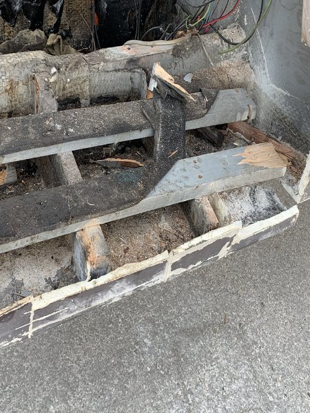

This shot gives a better idea of where my 'lower' hull side depth near chine was captured. You can see some variation by section but it is unclear if this was a conscious decision by Trojan or just variability / lack of consistency in layup boat to boat.

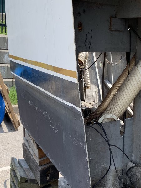

This shows where that last shot was taken from ... if you count from the right, this was the 4th section... 5 sections show in this shot.

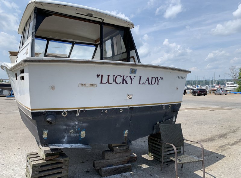

Not sure what he was cutting out, but this is the location that sample was taken from (low on the transom, center line, near where most F32 swim platforms would have been). Note, she was NOT a 'Luck Lady'...

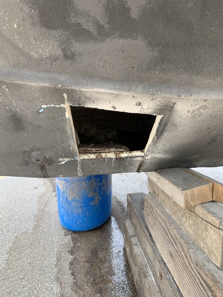

Originally I thought he cut out the forward through-hull /drain plug, but this pic shows clearly not. Don't know why he cut that hole, but you can get a sense of hull thickness forward. That's probably pushing 3/8 to 1/2 inch or more. Again, solid glass.

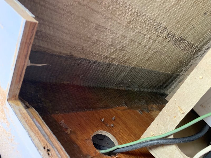

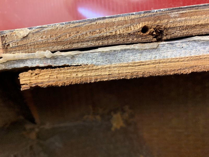

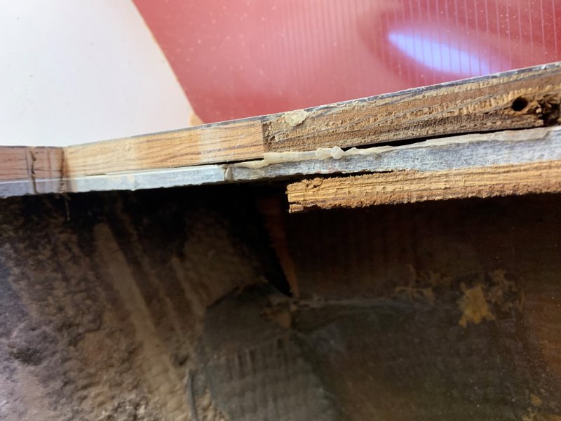

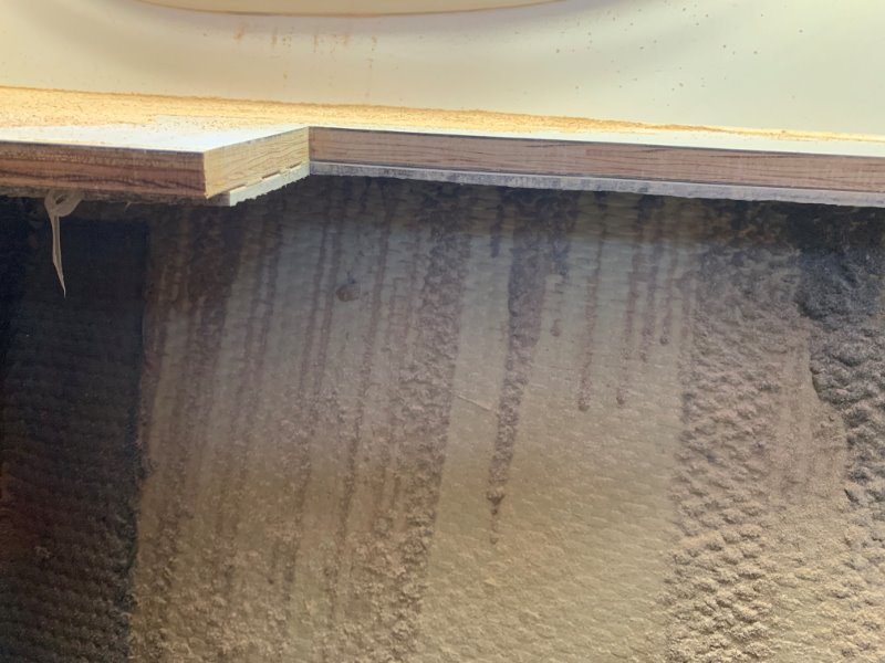

Take a look at the photos below

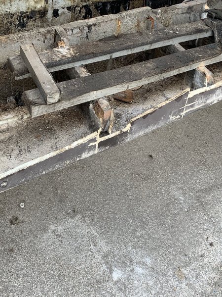

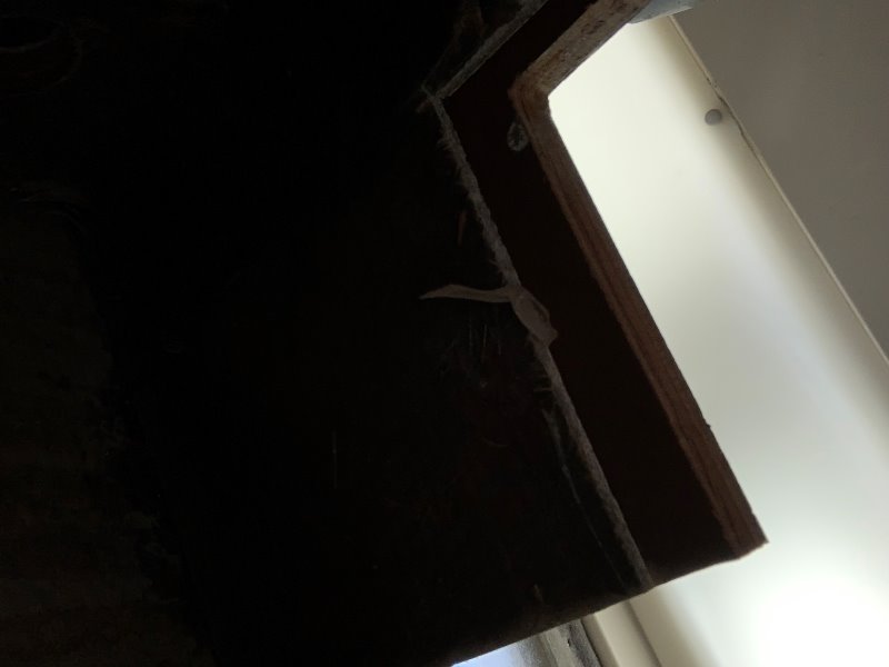

10 meter Express - galley area
The Schoell design was to strengthen EVERYTHING by tieing it together
look at how the galley is tied to the fiberglass coming off the side in a sandwich
These cuts were done to upgrade the galley sink and stovetop

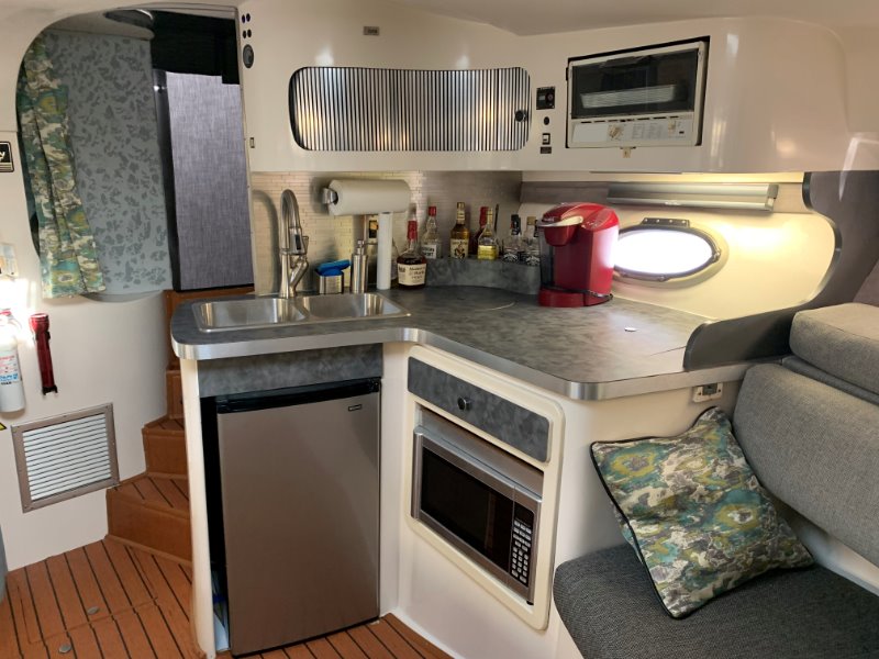

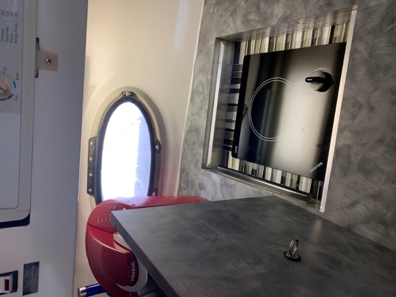

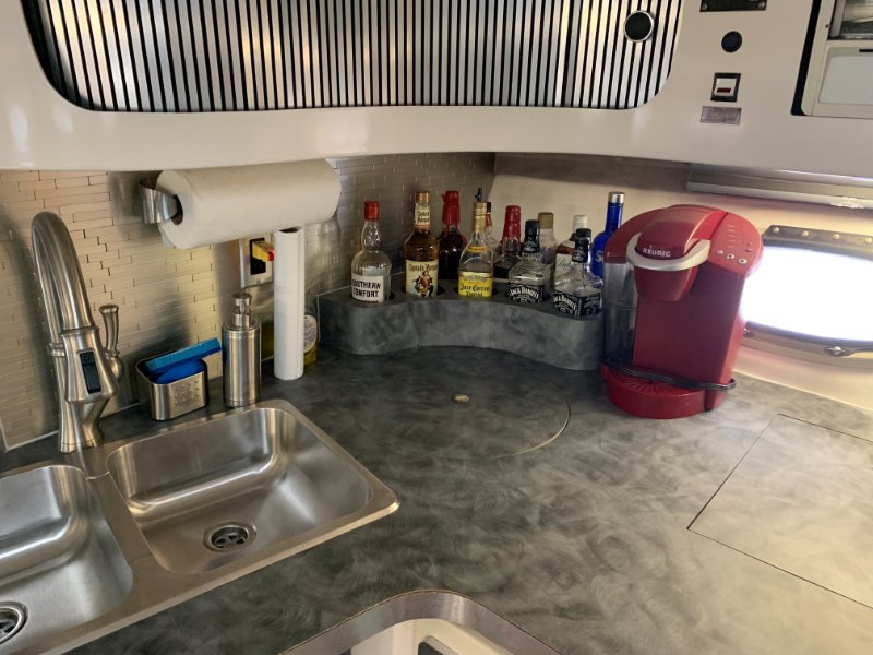

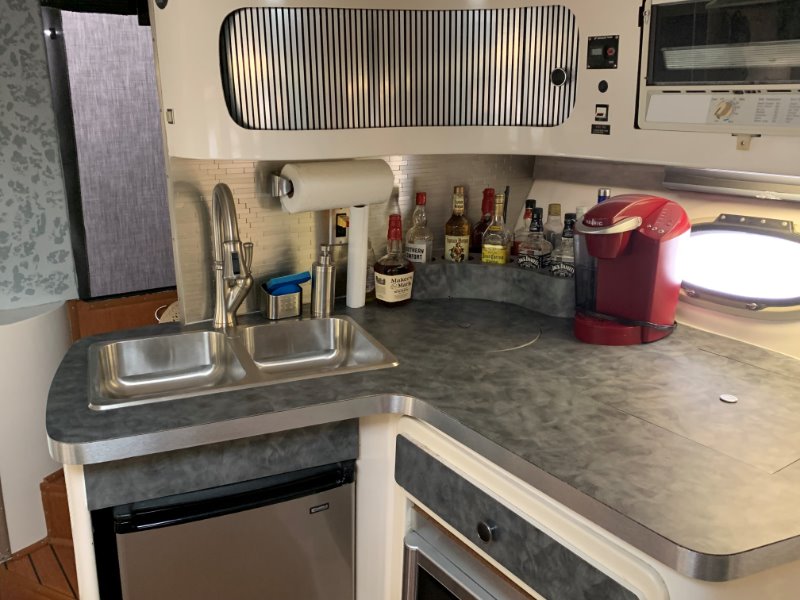

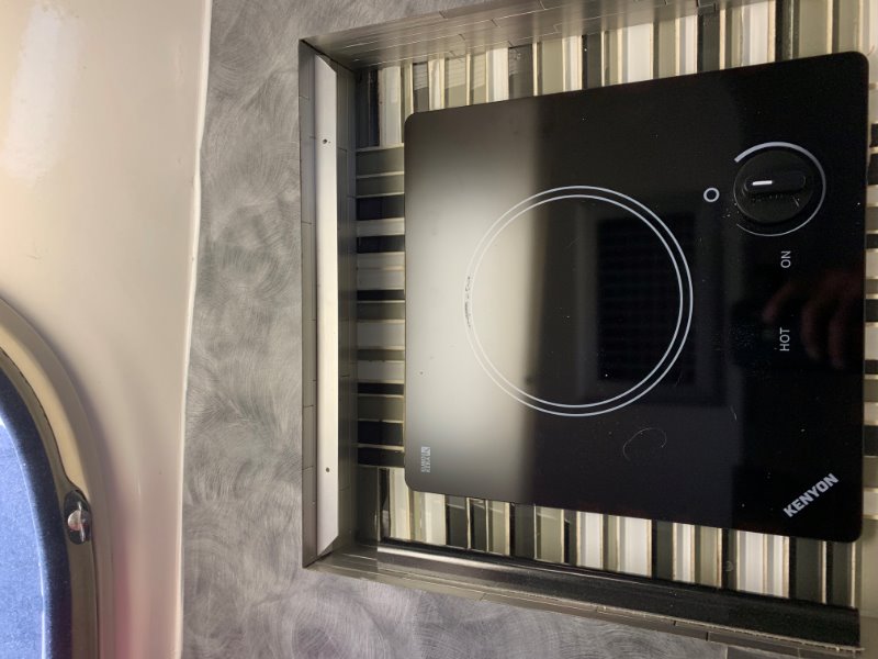

off topic but here's the finished product with new formica, sink & recessed stovetop:
