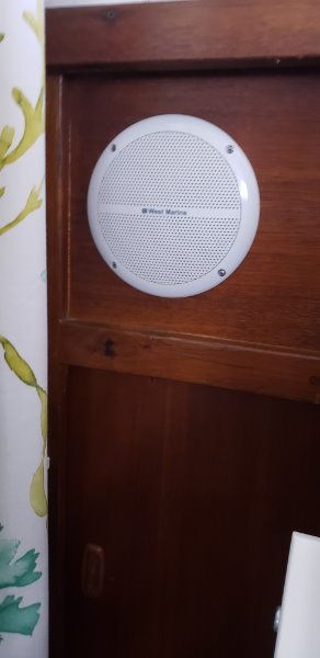

Before I started this thread, I had replaced the old cassette deck in the salon with a CD/Bluetooth receiver. The speakers in the salon were single cone West Marine speakers that really didn't sound good at all. Since we use the stereo all the time, it made sense to upgrade the speakers to take full advantage of the stereo.

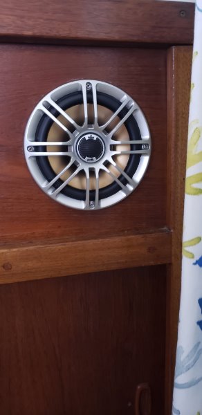

On previous boats, we have been very happy with Polk DB651 speakers and I found out that they were being phased out. After looking at the replacements, I decided that I liked the old ones better and bought a pair to install. They sound quite a bit better!
Out with the old:
In with the new:

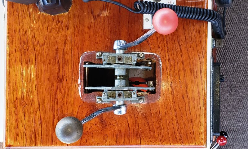

As a teaser, we went from controls with five inches of slop in neutral:
Controls - Neutral.jpg (118.43 KiB) Viewed 20474 times
To controls with minimal play and friction:

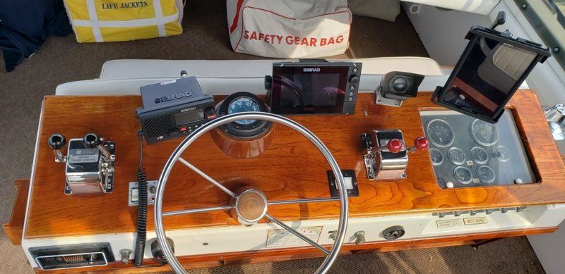

I have begun a journey to display my engine gauges on a chartplotter. There are some issues with using AC Delco gauges, and I will cover the process and final configuration in this thread: RS11 Installation
The final goal is to display the gauges on an easy to access screen on the chartplotter, and even more important, be able to set alarms that will be displayed when an out of range condition occurs. I will have Engine Coolant Temperature, Engine Oil Pressure, RPMs, Exhaust Temperature at the Y Pipe and Port Engine Voltage monitored.
