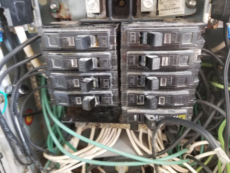

Are there separate neutral bars in your panel for the two cords? If not, that would probably cause the pedestal GFCI to trip depending on how the selector switch is wired.
Do you have the factory wiring diagram and is it still accurate? If so, can you post a photo of the AC panel wiring and I will be happy to look at it.

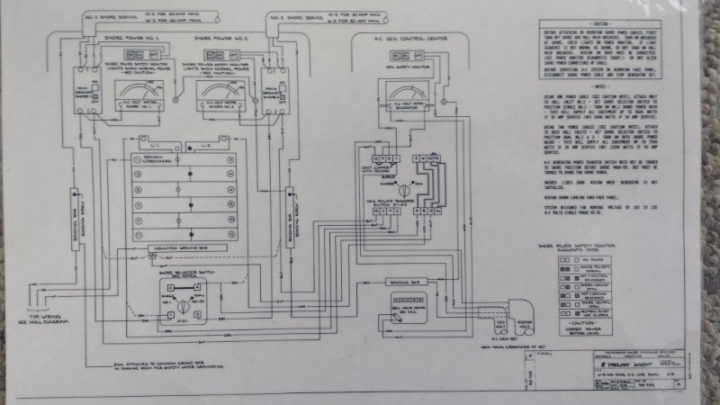

I hope i attached the file correctly of the A/C wiring diagram.
with the shore selector to line 1 and line 2 main breaker off, it would seem that line 2 white and black or not in the loop, only that green is going to bonding bar. I'm not very good at electrical but could it be a difference in in the green between the two power cords?

Ramblin, I can't read the fine print on the schematic you posted. If there is any way to get a clearer copy, that would be great! Also a photo of your AC panel if you have it.
El L Sea, if you have a single power cord, having all the neutrals tied together is correct. If you have two cords, you cannot connect the neutrals together without risking the pedestal detecting a ground fault and tripping the GFCI.

The GFCI only looks at the current going through the line and neutral wires, not the safety ground (green wire). I don't think the ground has anything to do with it unless plugging in the second cable is causing some of the current that should go through the neutral to return on one or both of the grounds.
That makes me suspect you have the neutral and ground tied together somewhere on the #2 side of the panel. This would be common on a house panel, but not allowed on a boat. Maybe a previous owner was not aware of this?
