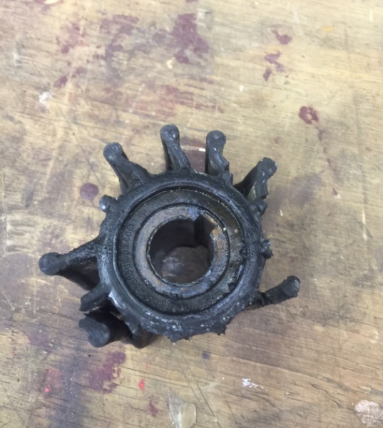

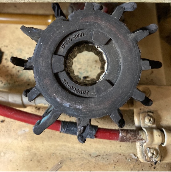

Don’t let this happen to you. Now is the time to change your impeller(s) before the season starts.
On an open or closed cooling system -- if you blow a impeller you need to find every piece before installing a new impeller.
The general rule:
Most manufacturers recommend every two years. It's probably a good idea to change them every year.
If you try to stretch it to three seasons, it's very likely that you'll begin throwing vanes. The time and effort it takes to find all the shards of a broken impeller -- will have you wishing you'd replaced the impeller.
It is our opinion that every Captain should know how to change the impellers on his boat and carry a minimum of one new impeller on board for emergency replacement. If you do not know which impeller you need for your Trojan -- text, email or call us.
