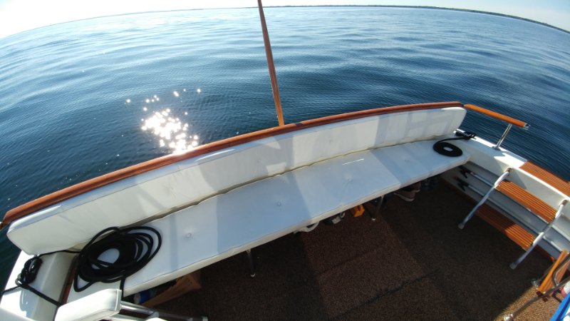

I am going to replace my Teak transom gunnel cap with Starboard. Has anyone done this ?

I love the teak. but I am trying to minimize maintenance. We can run up to 175 trips in a summer and I do not not have the time to do maintenance costs. We are out every day, and switching to starboard will save a bunch of time and hassle. The teak gets beat on by fishing rods etc and just has too much upkeep. Same as why I am adding the hardtop, eliminate a future maintenance item

I believe my teak was already replaced. Does anyone know what the thickness of the teak gunnel cap is supposed to be? Thanks

With 800 hrs a year of charter use. the teak does not hold up. I have stripped, many cetol coats. and the abuse from fishing rods whacking on it kills it. Resale, no concern. This boat is not going anywhere, I do not plan on replacing it. It fits the needs for my business. What I do want to so is eliminate maintenance. Starboard has no issues long term. Biggest question is does anyone know what the thickness is on 10 meter teak gunnel caps. Mone was replaced by the previous owner and looks thicker than normal
