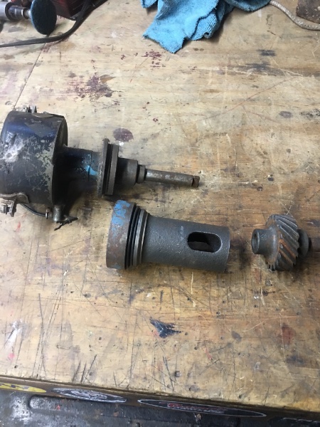

on 1976 Chrysler 318 CW and CCW distributors, do I need to buy the same units or different version for each rotation?
I also heard one side has a plate that lifts the distributor around 1/2" to make the same unit work?
If this is true, what does raising it slightly do mechanically to make it work ;-)
Thanks!

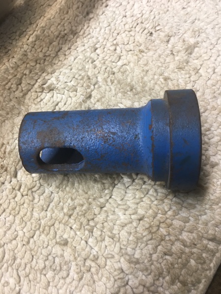

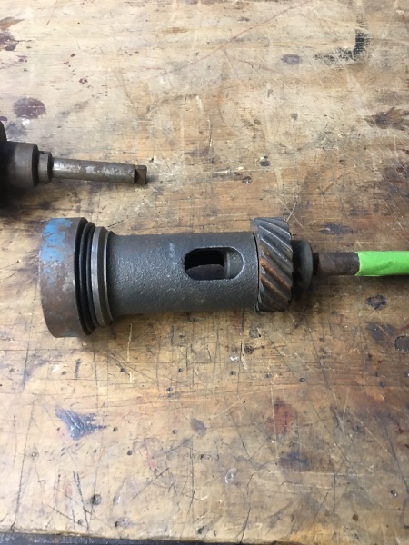

Both distributors turn the same way . On the reverse turn engine (clock wise / right turn ) a spacer is used to keep the oil pump/distributor drive gear from riding up on the cam gear . I do not remember if the distributors are different
Posts: 275
Re: 1976 Chrysler 318 CW and CCW distributors
Both distributors are the same.
The clockwise 318/360 has a collar which keeps the distributor drive gear in place. Without the collar, it would ride up and wear the cam gear as it would not be fully engaged. Engine direction is always from the flywheel. Setting on the drive looking forward. An automobile distributor will not work on a CW 318 or 360.
