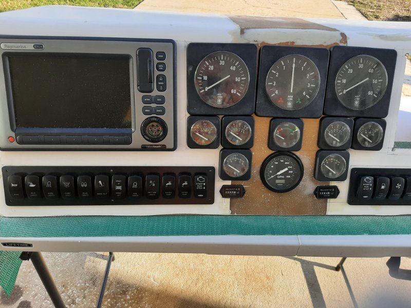

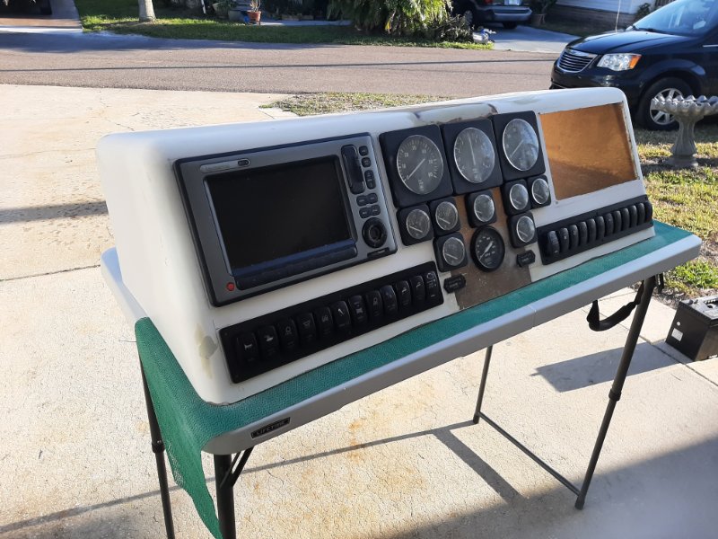

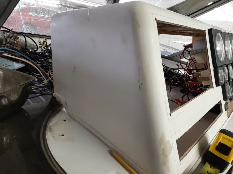

Did some fairing on the console as well as cutting holes for gauges and instrumentation. Also, I layed up the back panel with plywood coring to put all if the electrical connections on. We are just about ready for paint on the console itself

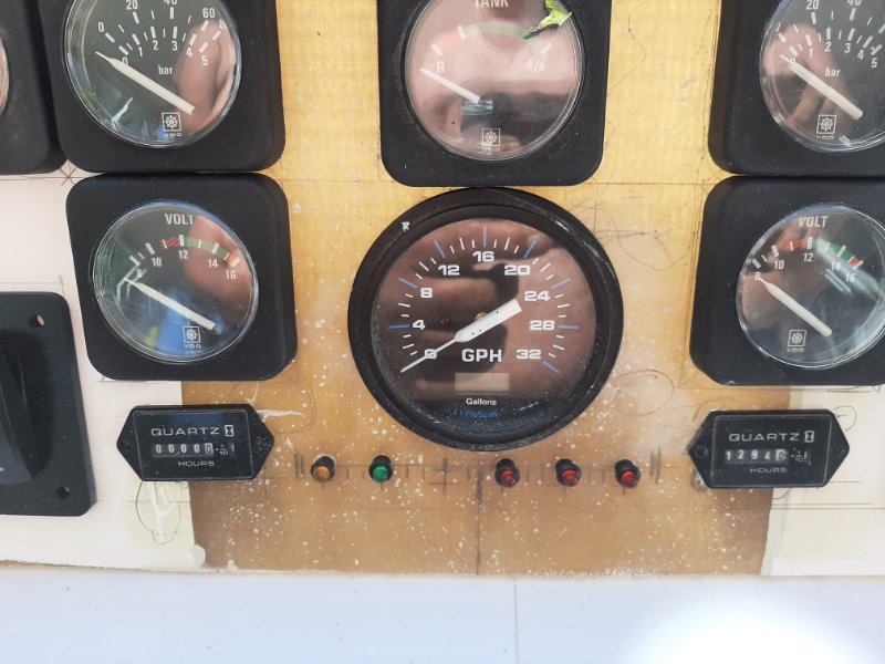

Added some indicator lights. Being a charter captain it is important to identify potential failures. The amber light will indicate when the vacuflush pump is activated just in case something keeps the seal open...this has happened leading to diaphragm failure. The green indicator is for the wash down pump in case it gets airlocked or the nozzle doesn't close. The 3 reds are bilge pump indicators.

Making progress on wiring. Here is a test of gauges and 1 of the switch panels.

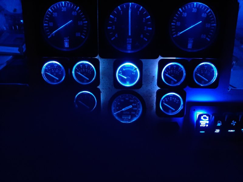

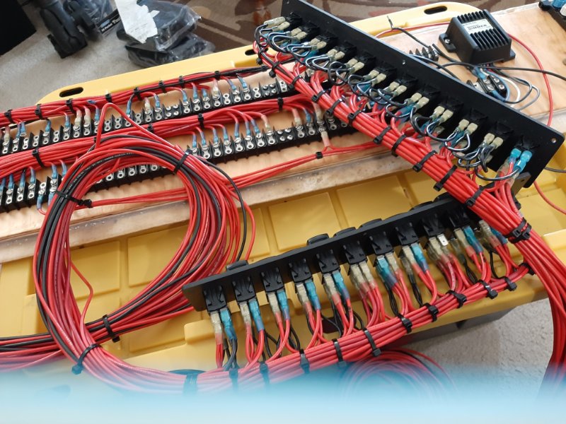

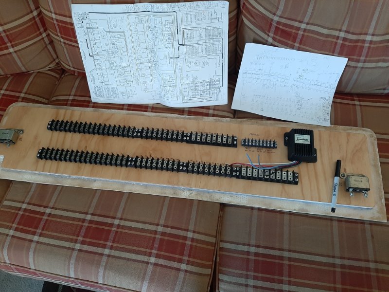

Here is the back panel. I laid it up with resin coated 1/2"ply glassed to the inside. Terminal strips are labeled. Blue seas dimmer to control instrument lighting. Rectangular boxes are stall/no oil pressure buzzers

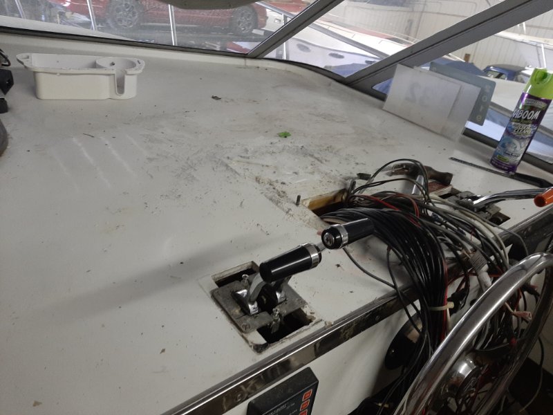

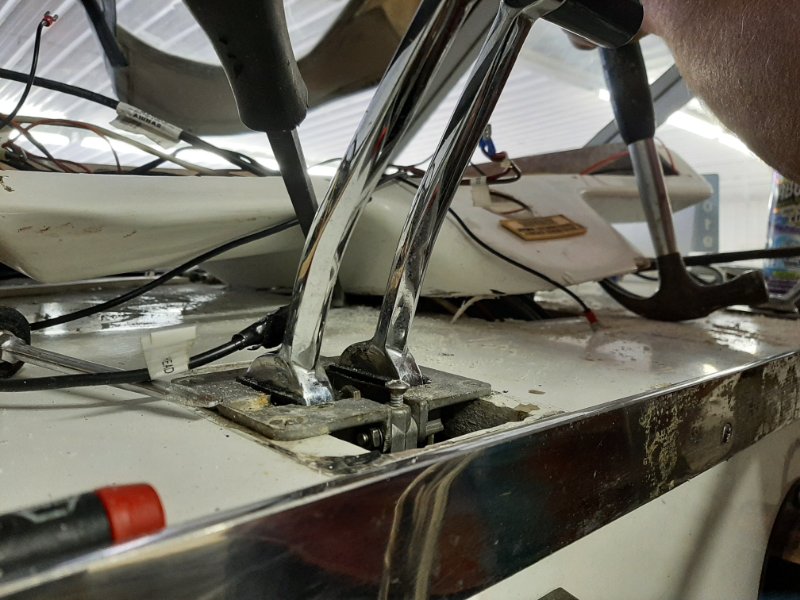

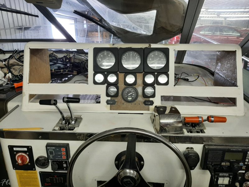

Finally got the dash free. After many methods did not work. an additional 2 hours of prying got it off. You can see I also removed the hard to find Morse SF controls that I will offer here before listing online.
Test fit the dash again after clearanced out for the door as you can see in the pics before I removed the controls.

Today, I removed the SF controls and widened holes for the top mount Morse.

Making headway on the wiring. Just put the heat gun to these connections. This loom will have tobe removed for paint and install. Next is preparing the boat side of the wiring.
