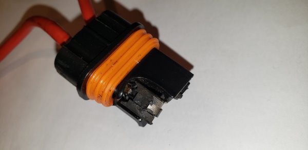

When I installed a ProNautic 1230P battery charger in our boat, I made a logical but poor component choice that could have resulted in a fire!
The instructions call for a 40A fuse at the battery, but I could only find a fuse holder rated for 30A at any of the local chandleries. With the boat in the water, dead batteries and a bilge full of water, I bought it along with a 30A fuse and planned to upgrade them if the fuse ever blew. My thought was that a fuse holder rated for 30 with a 30A fuse was marginal as per the instructions, but the only risk was blowing a fuse and the batteries not charging. Boy was I wrong!

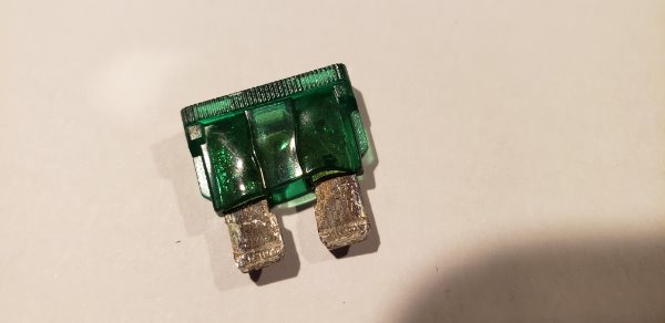

Fast forward five years and I noticed that one of my batteries was not charged and the charger was not doing anything about it. Upon inspection, I found that the connection between the battery and the charger was broken, and the cause was the fuse/holder had melted! On the side that was not charging, the fuse holder and fuse crumbled into dust in my hands when I tried to take it apart.
ProNautic Battery Charger Install Problem

- 20210621_134505.jpg (29.02 KiB) Viewed 6057 times

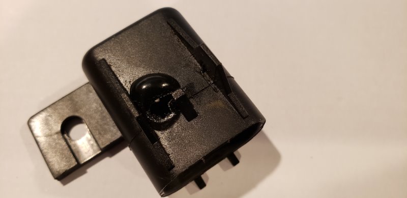

When I inspected the other battery's fuse, I found that it had also overheated.
- 20210621_134602.jpg (30.41 KiB) Viewed 6056 times

Since these were not cheap no-name fuse holders, I contact Blue Sea Systems tech support to see what they thought the cause might be. My concern was that this was not a random failure because it happened to both sides and with the 30A fuses not blowing, I had not exceeded the design criteria.
After some discussion, we concluded that while the fuse holders and fuses are rated for a maximum of 30A, they are unable to handle the heat generated by a sustained 30A of current over a longer time. Blue Sea Systems generously upgraded me to some of their significantly more expensive MAXI fuse blocks at no additional cost to me. These are capable of a maximum current of 80A, so plenty of excess capacity for my application. The install was a little more complicated, but I am happy with how it turned out and impressed by how Blue Sea Systems stood behind their product.
