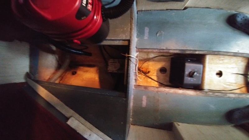

AwayOnBusine$$
Posts: 240
Re: F32 Hollow Keel
Post by AwayOnBusine$$ »
This is a view of the holes that I mentioned in a previous post.
F32 Fly 1975

thanks for the pictures, boat coming out next week... gonna get water out before winterizing

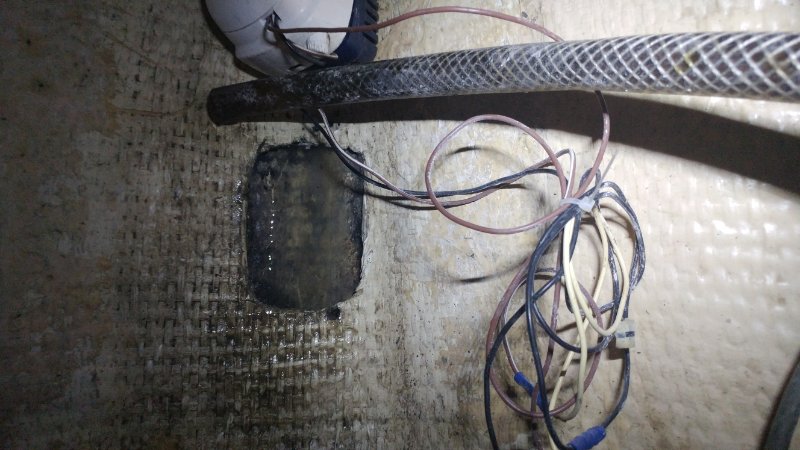

Actually created a new hole up front and lowered a bilge pump there.

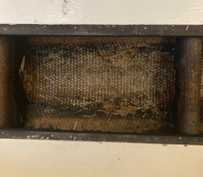

Am I correct that the “hollow keel” is under this glass matting?
And yes I know it’s filthy—My apologies!
If so, how deep is the keel/void?
