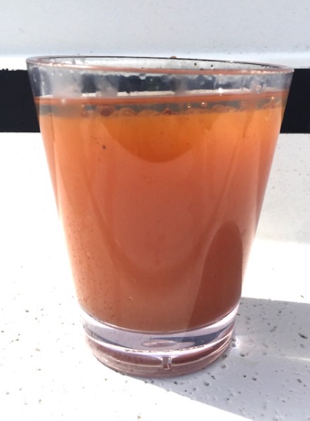

Simple question: Did you check the contents of the old gas filters when you changed them? Hope they didn’t look like this
- B6BB040D-4BEB-426B-944E-6656A0309822.jpeg (54.7 KiB) Viewed 7085 times
