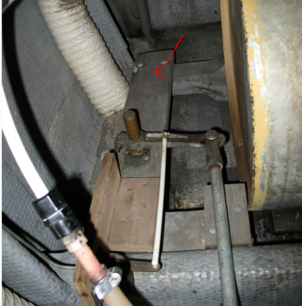

No not the actual rudder box, I’m speaking of the wooden brace that runs between the stringers—the top of the rudder runs through it. I don’t now the technical term for it 🤷🏻‍♂️
Re: F32 Rudder

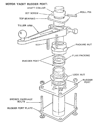

Are you talking about this piece of the framing, that I think the top bearing (?) it attached to?
Rudder Config.PNG (730.07 KiB) Viewed 9210 times
I believe in our config the rudder arm is above the top bearing, not below it as shown in this diagram.
Typical Rudder Setup.PNG (35.91 KiB) Viewed 9210 times

Yes that’s it! My “framing boards” if we’re calling them that, are carriaged-bolted to two other boards that are sister’ed (bolted) to inside of the stringers, and I think also support the gas tanks. From your picture it looks like yours are directly lagged to the top of the stringer, which I wouldn’t mind doing if the boards were longer. Mine is a ‘74 FWIW.
