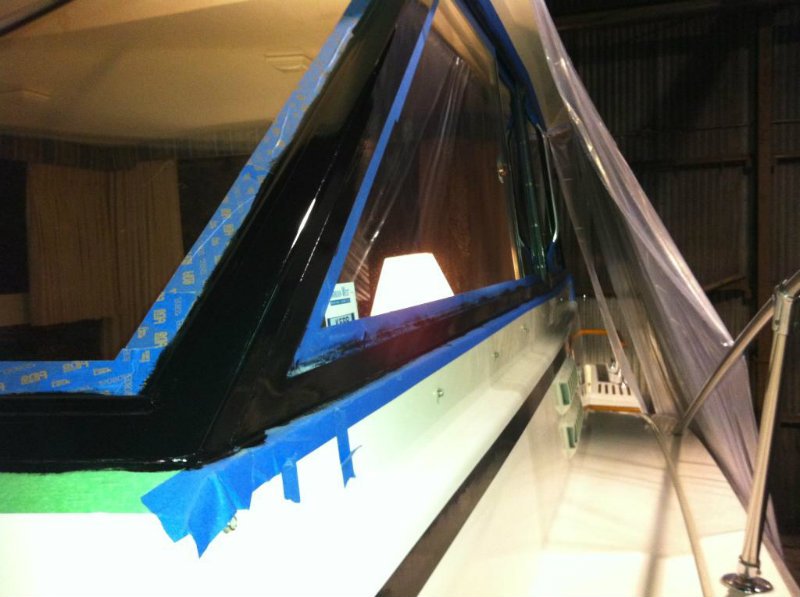

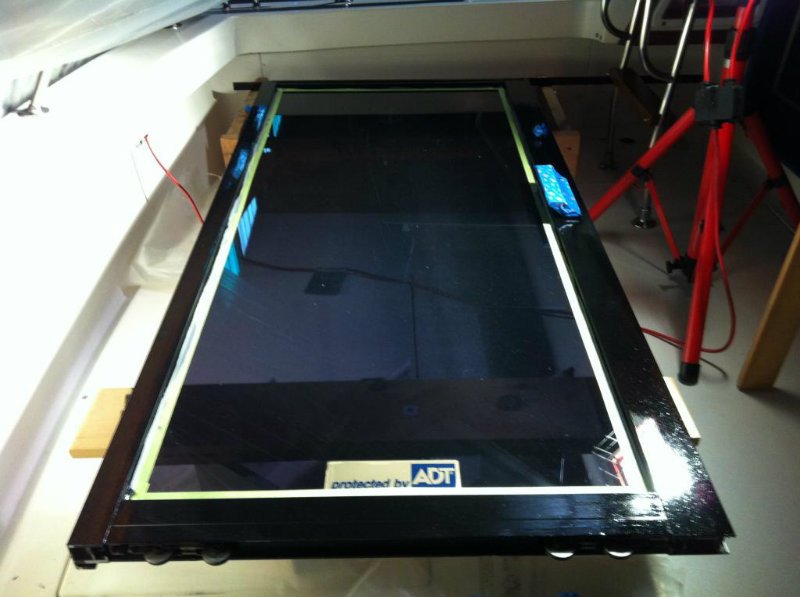

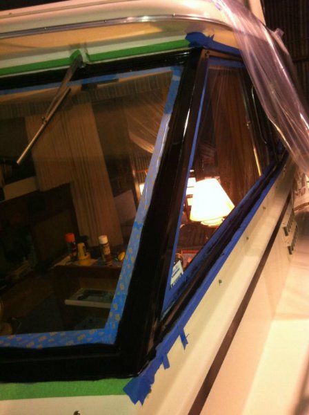

Found some pics. Here is a library of some shots. Lighting in the shed sucks, so iPhone pics don't really show off how well it looks now.
