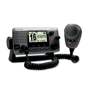

I bought 2 Garmin 200 VHFs.
https://buy.garmin.com/shop/shop.do?pID=28721
They are linked with my garmin 7212 plotter and garmin auto pilot.
I couldnt see buying a vhf that wont link to your gps for safety reasons, especially going off shore even a couple miles.
