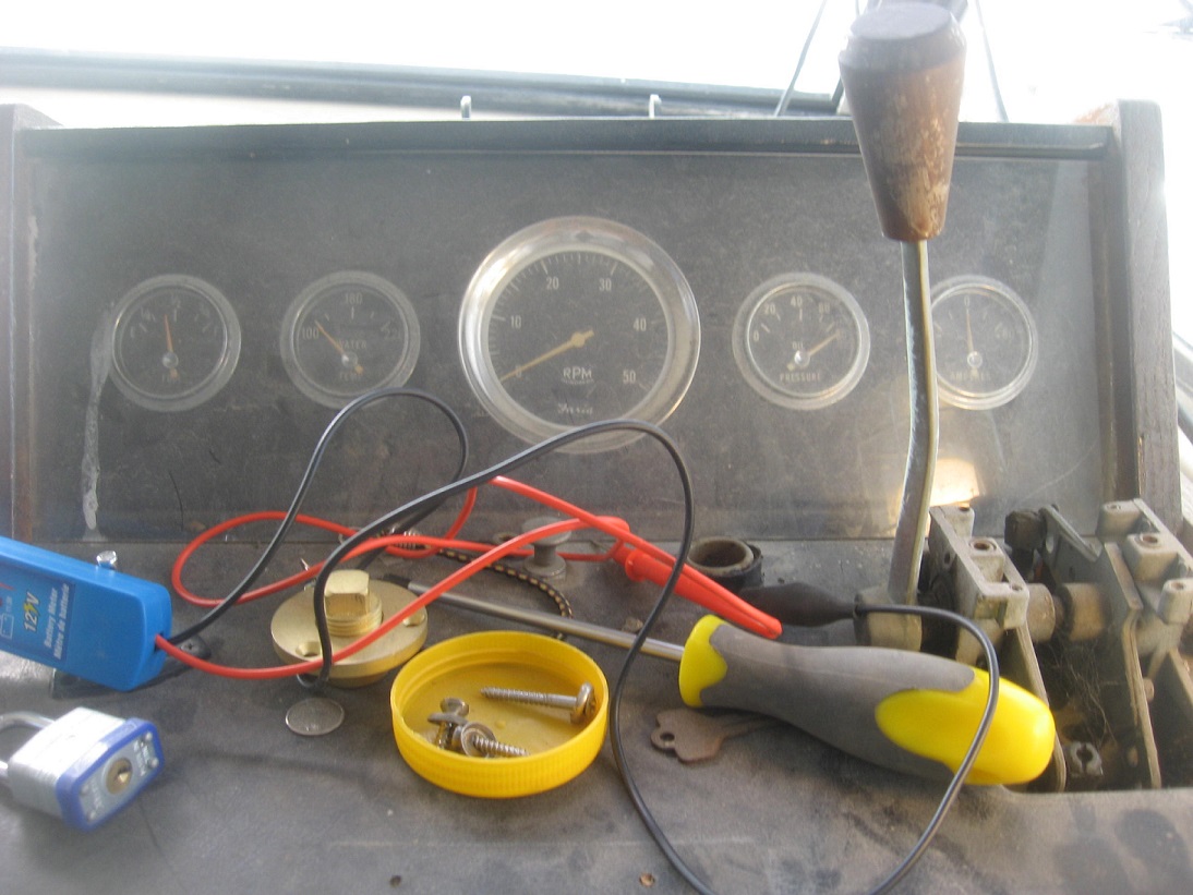

Reading of fuel guage with key in off position with tanks empty apperantly. while there just bellow the rpm guage there is what looks like original push pull Trojan button that not sure what its for . Maybe someone knows before I start tracing the line .

Most gauges should have the needle all the way to the left with the ignition off (the Ammeter should be in the center). Looking at the picture you posted, I'm fairly confident that your fuel gauge and oil pressure gauge are not working. I would expect the temperature gauge needle to be a bit further to the left, but it may be working.gordd wrote:Reading of fuel guage with key in off position with tanks empty apperantly. while there just bellow the rpm guage there is what looks like original push pull Trojan button that not sure what its for . Maybe someone knows before I start tracing the line .
Replacing the oil pressure gauge and sender is fairly easy. The oil pressure sender is located next to the distributer and screws into a 1/8 NPT fitting. The fuel sender can be a little more difficult to replace. Is the top of your fuel tank clear of obstructions? If so, replacing the fuel sender and the gauge is probably your best bet. In my boat, the fuel tanks are located under the deck so to replace the senders I would need to remove the tanks. I'm trying to work with the fuel senders I have so I don't have to remove the tanks.
Hopefully your temperature sender is working. Mine wasn't, and I wasn't able to find a replacement sender that would fit the space. I ended up buying a part from Jaguars That Run in CA to put a temperature sender in the hose connecting the engine to the thermostat housing. It works, but I would have prefered to use the same location as the original temperature sender.
Good luck! If you have any other questions, please ask.

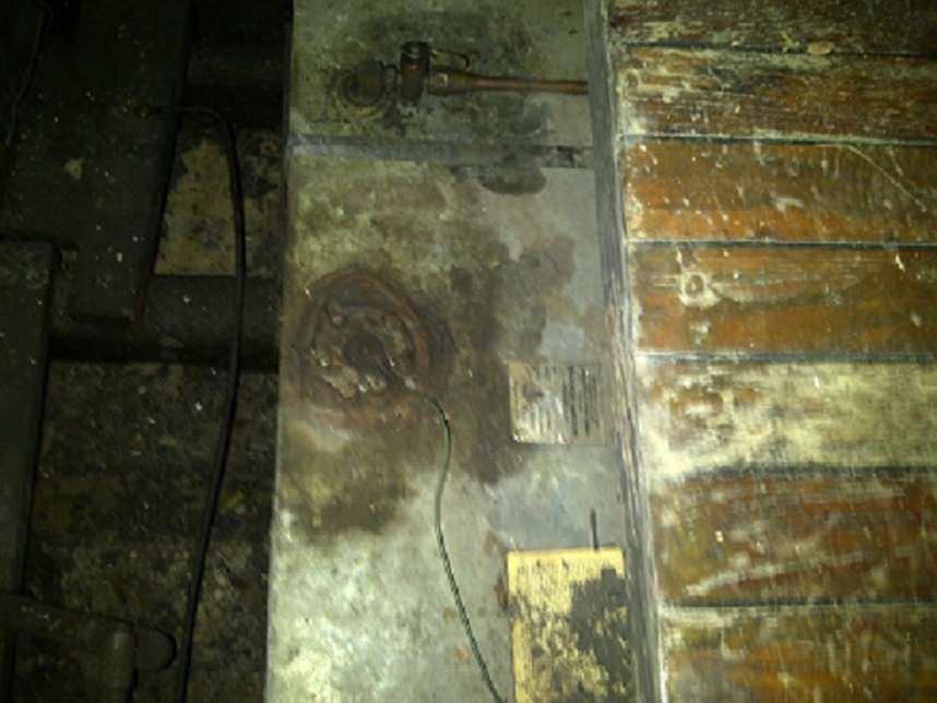

Thank you DogHouse and BigD .. I meneged to losen up shut off valves tonight so that made me happy ..Started up engine again and started fine .. but ran out of light to replace filters to see if that is cause .. will do that in morning . Then will hook up portable tank or try to . I have to buy one with appropriate hook up. This is pic of the fuel sender area and shut off valve on top of tank .. I chatted with Bob tonight as well and he gave me few hints but still nice to see how others do it
- fuel sender on top of tank with shut off valve

Congratulations! It's the small victories that keep us going sometimes. Since the top of your fuel tank is open, it shouldn't be too difficult to replace the fuel sender if you have to. You have much better access to the top of your fuel tank than I do. Keep at it and you'll get everything sorted out.gordd wrote:Thank you DogHouse and BigD .. I meneged to losen up shut off valves tonight so that made me happy ..Started up engine again and started fine .. but ran out of light to replace filters to see if that is cause .. will do that in morning . Then will hook up portable tank or try to . I have to buy one with appropriate hook up. This is pic of the fuel sender area and shut off valve on top of tank .. I chatted with Bob tonight as well and he gave me few hints but still nice to see how others do it
