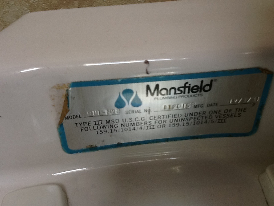

Re: Head question
Here is a photo of the label on the back of the toilet.
- image.jpg (147.09 KiB) Viewed 7655 times

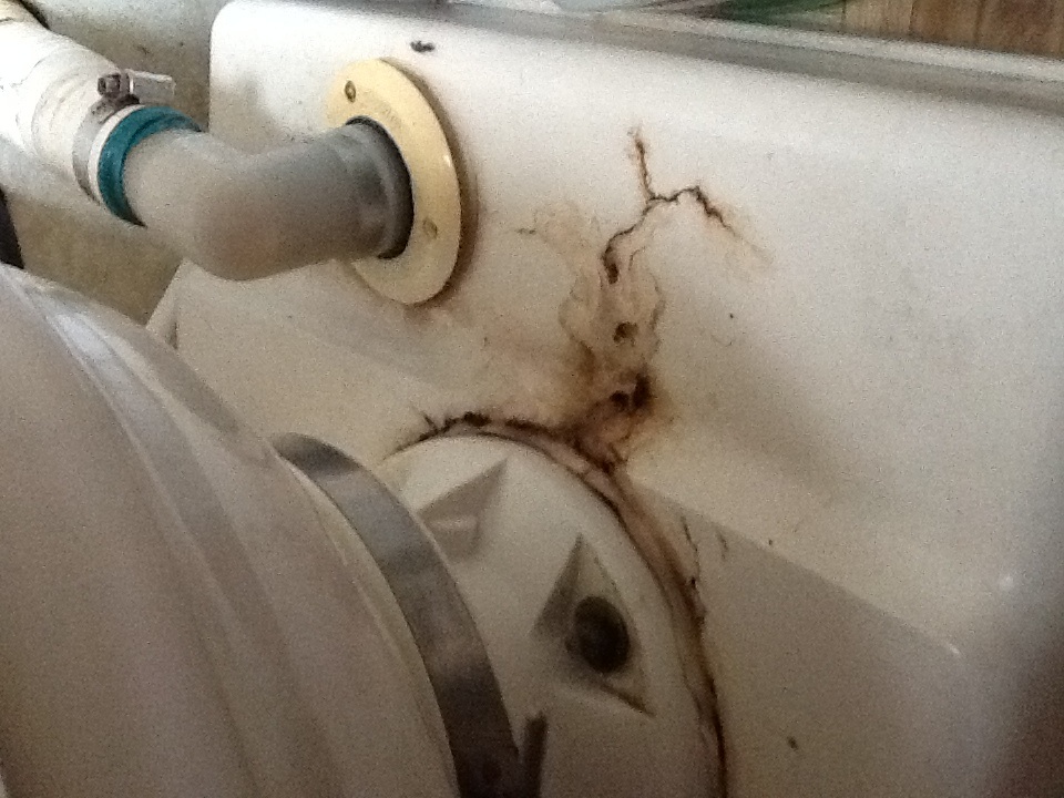

Re: Head question
And here is a photo of the nasty "repair"
- image.jpg (220.58 KiB) Viewed 7655 times

Re: Head question
Looks like the built in holding tank is cracked . I don't know if you can find replacement tanks for that head. On my F36 I installed a new head and used a remote holding tank . Its was a lot of work and some $$ . For me that was the only way to go . the other option is to try and do a repair , but that may be short lived . Or replace it with another unit with a built in tank . Or maybe even a composting type head ? Not my choice but I believe someone on hear has one and likes it .

Re: Head question
Yuck. You definitely need a new tank, if available, at a minimum. Have you tried contacting Dometic/Sealand to see what the scoop is on this unit? http://www.dometic.com/enie/Internation ... o-SeaLand/

Re: Head question
Of course I haven't seen or smelled it in person, but I'm not sure that you need to replace it. My inclination would be to stop-drill the ends of the cracks, sand the area, clean it with an appropriate solvent, and reinforce the area by laminating a patch over it. For $50 and two hours, you could find out if you could get a few more years of service out of it. If it doesn't hold-up, then you could always go the replacement route.
I'm not sure what the material is, but even if it is a difficult-to-bond high surface energy material like polypropylene, you can flame treat it (be sure to do the patch too) and use a urethane adhesive like this one from McMaster-Carr.http://www.mcmaster.com/#catalog/119/3390/=nf1dtt They would also have any material that you would need for a patch. I live in central Maryland. I can order form MMC at 6:00 pm, and the goods are on the doorstep when I get home the next day.
You can find a flame treating demo here:http://www.youtube.com/watch?v=GTiCWp0unjs
Lest us know what you decide and how you make out.
PS: If you use the adhesive I called-out, you might consider a stopwatch or someone keeping an eye on the second hand for you. Let me just say that stuff sets-up fast, and you don't want to get behind the cure curve.

Re: Head question
Yuck is right. I have the same head that I pulled out of my 270, and replaced with a new head and remote holding tank, which IMHO is the best way to go. If you are interested, I have the head for sale on KIJIJI for $50.00. I could split it and send just the tank or the whole unit. No idea how much to ship, if you are interested, lemme know and I'll look into shipping costs. I know these units are over $500 at W.M.
Again, IMO the BEST fix is a new head with remote tank.

Re: Head question
DO NOT FLAME TREAT !!!!!!!!!! That tank may contain methane gas ( comes from waste )
Maybe after removeal and a good cleaning and venting

Re: Head question
Not to mention it is probably on a gas boat. I never dreamed that it would be done in situ. Does one really have to go into the safety minutia on every job, like wear your safety glasses and tuck in loose clothing when working with rotating tools? For $50, I'd go with a a new-used tank myself. Best of luck with the changeout. People often don't realize the value of the head until it doesn't work.tank may contain methane gas ( comes from waste )
