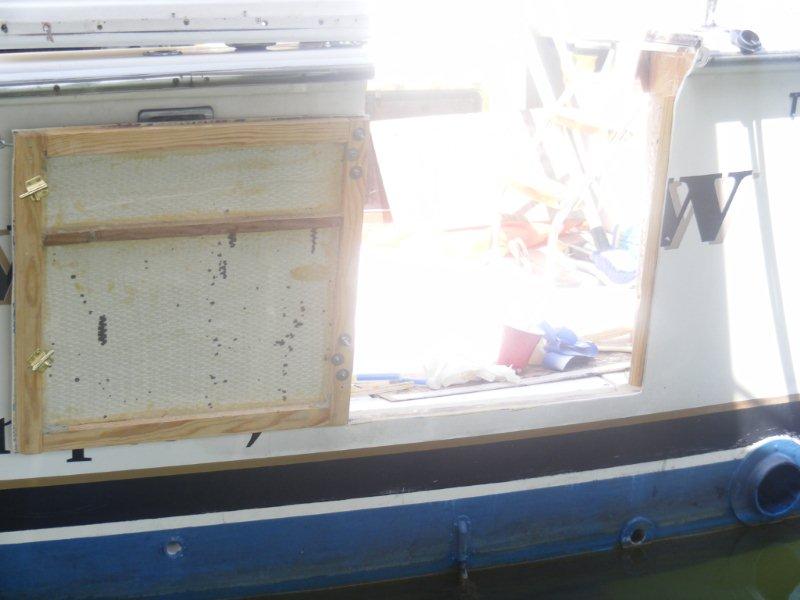

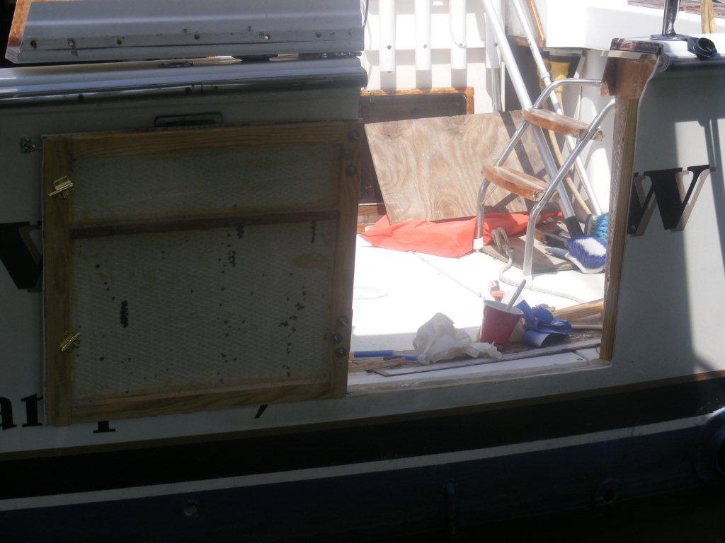

Still got a way to go . But the door is now usable as is the boat .The temps have been hanging around 60 deg and chances of rain . Not the best conditions for epoxy work . these where taken sat. got more done on Sunday .

Re: A small project or what have I gotten into
we appreciate the photos
I wish I took some sunday , I will try and take some more this week .I need a few days of above 60 and no rain and it wll be done .

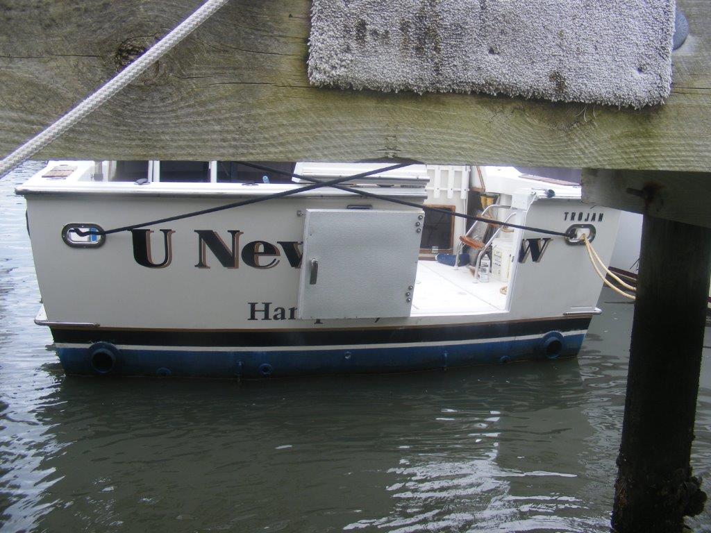

Well the door has been done and I finely got a good photo . But I have added 2 more holes to the boat . Do you see them ?
completed transom.jpg (133.18 KiB) Viewed 6388 times
Looks real nice, just like it came that way--- as for the holes ,my guess would be the aft line guides-- what did you fasten the cleats to ,I like that idea--- one other ? Where can I get a set of those two rung steps that can be seen in the background , are they original trojan?--- Mike
Your correct the hawse pipes are new , the cleats are exactly in the same place as they came , the OEM hawse pipes came in from the top and where smaller . I went larger so I could run the shore power through them also .
The steps are OEM Trojan
And thank you

Looks Great.

Like the door, and love the new Hawse pipes. Nice job!
