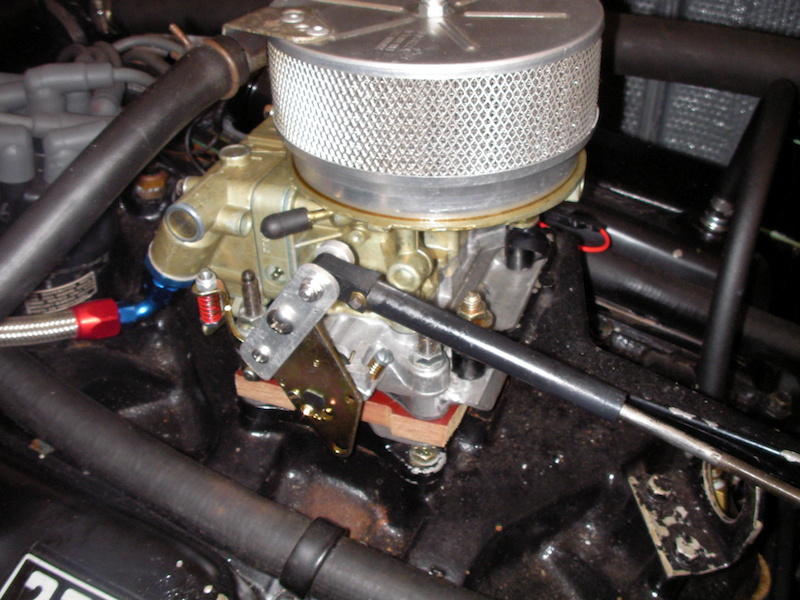

Hi,The boat starts and idles perfectly. Again, I have no trouble starting the engines at any time. Also, the engines never stall. I also have this issue, the old owner replaced the Rochester carbs with new ones... not Rochester, and in doing so used a shim and / or wedge to make them fit. But I have run the boat for 4 years and only started having problems last year.

A couple of questions----- does this only happen when the engines have got a good heat soak,before everything gets hot do the engines perform as normal----- that is just a spacer under the carbs,probably to keep heat from the carbs ---- if it is heat related look at coils and check compatibility with the ignition system----- are both engines the same???---- Mike
