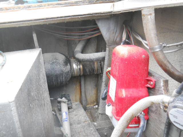

Re: Original Mufflers in F32
Mine are either plasic or fiberglass. Just looking at them I'm thinking plastic. Attached is an old picture that shows the end of one.
- 007.JPG (168.36 KiB) Viewed 6240 times
Yanmar 6BY3-260's
Yanmar 6BY3-260's
I would guess glass . Look close at it if its glass then you maybe able to see the fibers . http://www.centekindustries.com/vernatoneround.html
I've seen one of these blow due to a backfire. Appeared to be fiberglass. Nothing much to them at all.
