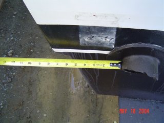

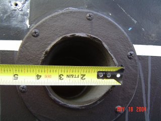

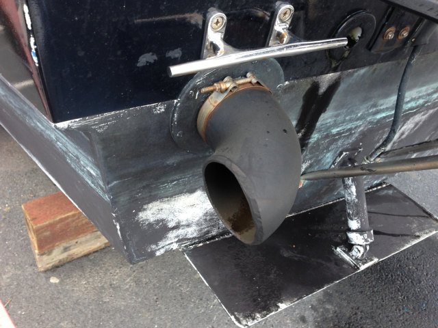

Here's a couple of images. One tip was broken off before i got the boat. I added the 90 degree elbows to get the exhaust out from under the swim deck, for less 'station wagon effect'. It works. I seem to remember cutting off the upper clam shell lip before installing the 90's.
- exhaust tips.jpg (17.2 KiB) Viewed 4455 times
- exhaust tips (4).jpg (71.14 KiB) Viewed 4455 times
- exhaust tips (3).jpg (15.85 KiB) Viewed 4455 times
