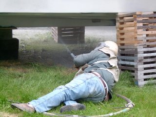

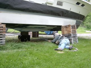

Silica is aggressive, but if that's what it takes, that's what it takes. You're gonna have a renewed barrier coat anyway. These images are silica blasting with the nozzle 3 to 4 feet from the surface.

those pictures of blasting and the 2x4 stands are pretty sketchy looking
Re: bottom paint
LOL, you need to spend more time in Alaska!!!! That looks pretty good by what I have witnessedK4282 wrote:those pictures of blasting and the 2x4 stands are pretty sketchy looking

The commercial boat yards in Alaska have hundreds of boats blocked this way every winter. The 2x4 boxes may look funky, but they never fail.gitchisum wrote:LOL, you need to spend more time in Alaska!!!! That looks pretty good by what I have witnessedK4282 wrote:those pictures of blasting and the 2x4 stands are pretty sketchy looking
