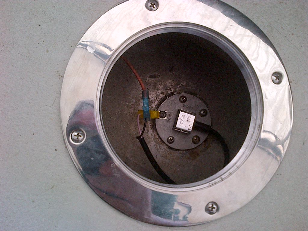

jhalb
Posts: 354
Location: St Louis Mo.
Re: 11Meter fuel tank sensor
Post by jhalb »
i had to make a hole and put in an access plate on my 10 meter. Changed the connectors later.
Fuel Sender.jpg (111.71 KiB) Viewed 4791 times
John
"PELICAN"
1983 10 Meter Express
Wema sender . Best way to go IMO :D
