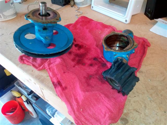

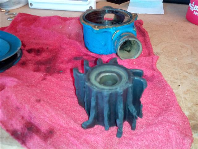

I removed the raw water pump today & upon inspecting the impeller reassured me of my decision yesterday! I should have known better... I should have inspected those impellers when we first purchased the boat back in April.

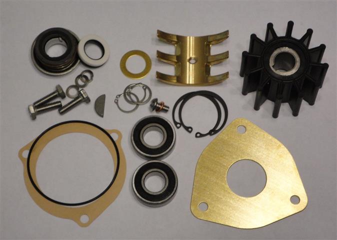

Ordered (2) total rebuild kits today (Sherwood #23977) & some new 1.250" ID hose for pump to oil cooler(s). I will pull the starboard pump off today & prepare it for the rebuild.

Wow. Those are pretty bad. It makes me wonder where the pieces went.

Reel Easy wrote:Wow. Those are pretty bad. It makes me wonder where the pieces went.
They most likey in the first cooler in line . He needs to find them

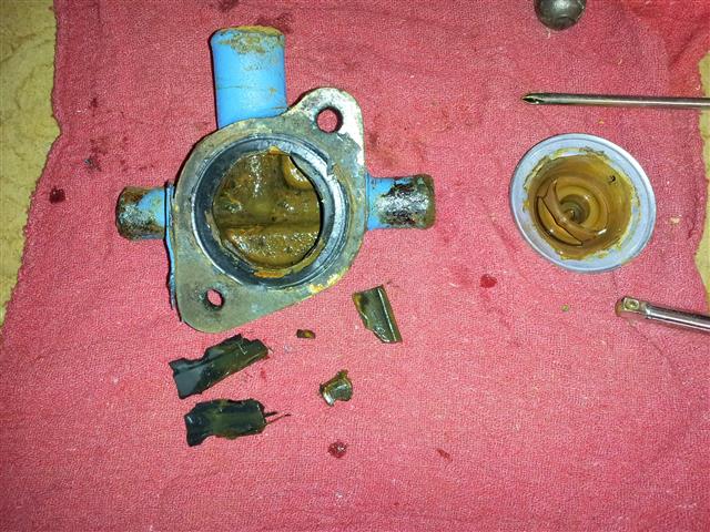

I pulled the thermostat housing off & found some large pieces of the impeller lodged inside. I wonder how many more pieces are in the engine circulating water pump! I'd better buy extra circulating pump gaskets as that will have to be removed for inspection also.

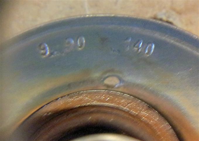

The thermostat is stamped 9. 90 140 I know the 140 is a 140 degree thermostat is the 9. 90 the date of mfg? Sept 1990?

Re: Sherwood G-7 Raw Water Pump
I have had good luck finding impeller pieces by back flushing the system with a nylon stocking on the end where the water comes out. If you match up the pieces, you can decide if there are any missing, in which case you need to take it apart to find them.

WayWeGo wrote:I have had good luck finding impeller pieces by back flushing the system with a nylon stocking on the end where the water comes out. If you match up the pieces, you can decide if there are any missing, in which case you need to take it apart to find them.
Good idea. I'll definitely do that, Thanks

Anyone have an idea of the stamping on the impeller? " 9. 90 " could that be the year it was manufactured?
