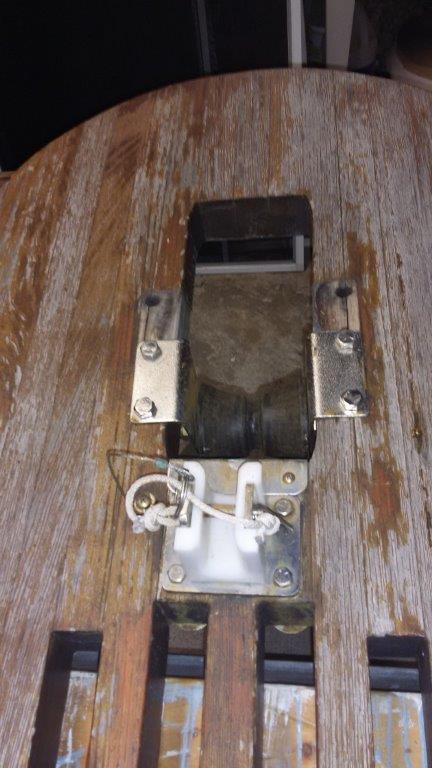

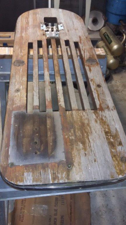

I'm starting a refinishing project shortly. I pulled the bow pulpit off of my 1988 F36. The wood is still in good shape, but is getting weathered. I bought some teak to make plugs for where the old windlass was and also where I moved some hardware for my new anchor. I plan on using gorilla glue to secure the plugs before finishing the wood. I also just bought a new Profish 1000 windlass to install on it when I am done. I was looking for some thoughts on how to create a long lasting solution. I plan on using a very thin penetrating epoxy for the first coat to get protection deep and permanently sealing the wood. Second I was going to use multiple coats of Cetol. Any advice?

Your Teak is badly discolored, ie. weather worn. Had a similar problem. Took the piece to a refinishing place and had them power plane a 1/64 of the underside and a 1/32 of the top side, followed by complete sanding with 100, 150 and 200 grip paper. you could cote with epoxy. I did not, just 5 coats of Cetol and 1 coat each year there after with a light rub of a sanding foam based block (3M stile)
P.S. I use epoxy for plugs. Don't forget to align the grain, you would be amazed at how many restorations I have seen where this has been overlooked.

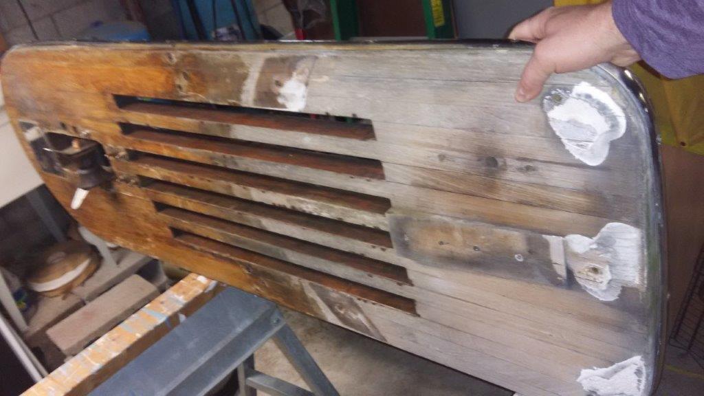

What type of epoxy did you use for the plugs? I was going to use Jamestown TotalBoat Penetrating Epoxy for the coating. Thanks for the grain alignment tip. There are some large plugs on the side covering the threaded rods that help clamp the pieces together. Right now there is some material that almost feels like chalk. What would you use to fill these holes?

There is enough thickness of wood there that you could get away with the planing that Away suggests. An alternative is a 2 part teak cleaner (acid first that really pulls the gunk out of the wood, then a base to neutralize the acid and bleach things) followed by sanding once things are dry with 120-200 grit just to get rid of any raised grain.
I wouldn't epoxy before using Cetol - I think that may even mess up the Cetol job as it won't be able to penetrate into the wood. That's what makes Cetol work so well - first coat mostly penetrates, second coat penetrates to a degree and starts to sit on top in some spots, third coat usually evens things out, and any coat beyond that is building up depth. If it can't penetrate, your finish will be as good as how well Cetol can adhere to the (slippery) epoxy, and you could find yourself trying to refinish an epoxied piece of Teak - much worse for the sanding or planing requirements.
For filling the 'big' holes, I wouldn't try to fill them necessarily. Remember - the problem isn't water... it's trapped water.
If you try to fill them and moisture does get in behind your plug somehow, it will be trapped and rot things from the inside out. That's the worst kind of rot - you don't see it until the structure fails. I would be more inclined to leave the void, but apply either several doses of Cetol or (if you think you need it) an epoxy (West System is usually my go-to) to seal the wood in those areas. With Cetol or epoxy penetrated into the wood, and it not being exposed directly to the elements, it should stay pretty waterproof for years or decades (a Cetol job I did on my flybridge, which is under cover when I am not at the boat, has lasted without maintenance for about 13 years so far). With the void itself being left open (and not plugged), any water that does get in will be able to either run away or evaporate naturally over a short period of time.

Take out the chalk material. I used west systems epoxy. I really don't think it matters what you use to secure the plugs as much as it matters to secure the base and a little of the lower portion. Make sure the size or depth of the plug will sit proud of the depth of the location. Tap it in gently to secure, then sand flush. Do not seal pulpit as indicated above with epoxy. Use cetol for all coats. Yes you can thin first coat to allow it to penetrate. My swim platform and bow pulpit have both been done this way. Once a year I give a gentle rub with a 3M fine sanding sponge, followed by a new coat. Takes an hour and looks great for the whole season.
