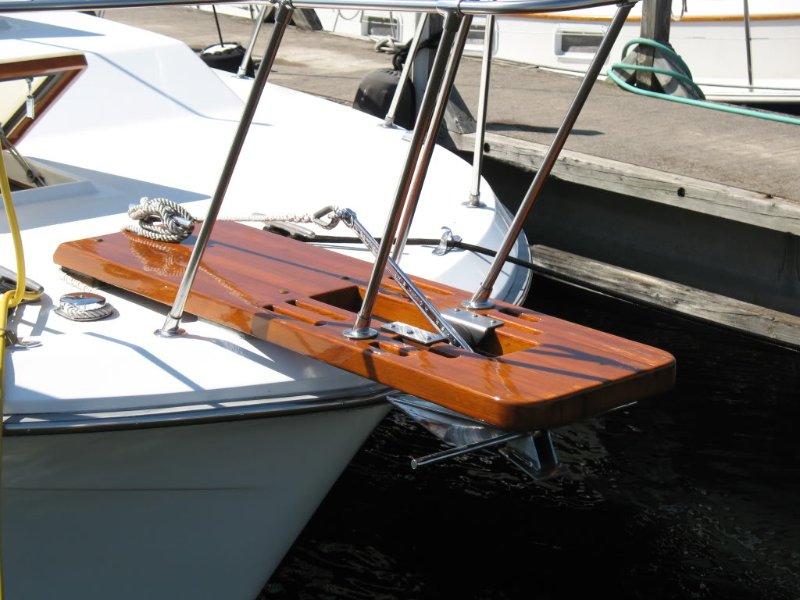

Cetol Light or Natural may give you the look you are after... This shot is Cetol Light with Cetol Gloss over top. The second one is a little fuzzy with the low light under the cover.

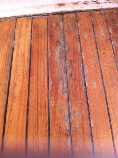

I must be the only Trojan owner with teak decks that has never refinished teak before. I'll post my progress in case anyone is interested because I haven't seen any pictures of refinishing teak that has black caulking strips. The thought of disturbing the black caulking had made me nervous.
I didn't want to use chemical stripper because I did a small area on a previous boat and it did remove the black caulking strips. I was worried about the same thing with a heat gun.
Good news, application of the heat gun until the finish just bubbles yellow, allows the surface to be scraped bare without affecting the caulking. I started with a 2.5" scraper but found the 1.5" wide better. Trouble is that you can only do about 1.5" x 2" square at a time. Extremely tedious work but very satisfying results. The foredeck took 17 hours and each side deck was 10 hours. The side decks were nasty because there is very little room to get comfortable between the shrink wrap and the glass.
Just started sanding with 100 grit on an orbital sander.
The whole reason for doing this is to get rid of the grey..... not showroom, but much better. The close-up picture, shows the grey I am trying to get rid of on the right, and the sanded wood on the left.
As per all the advice (above) and am planning to use Cetol Marine Light.
