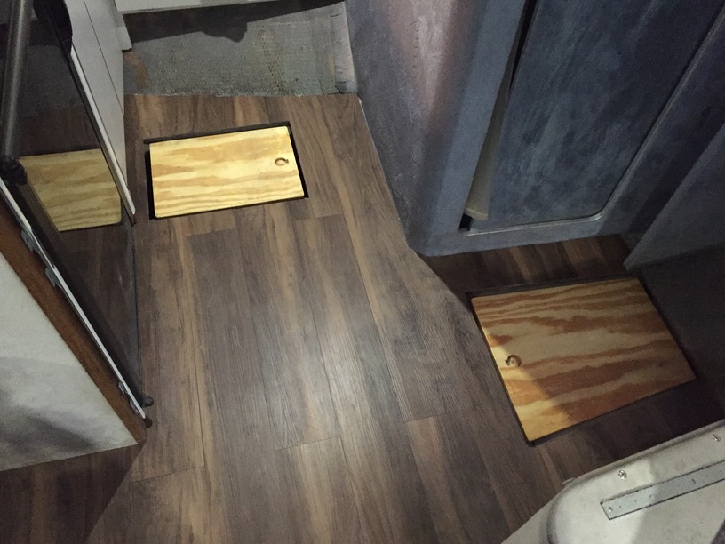

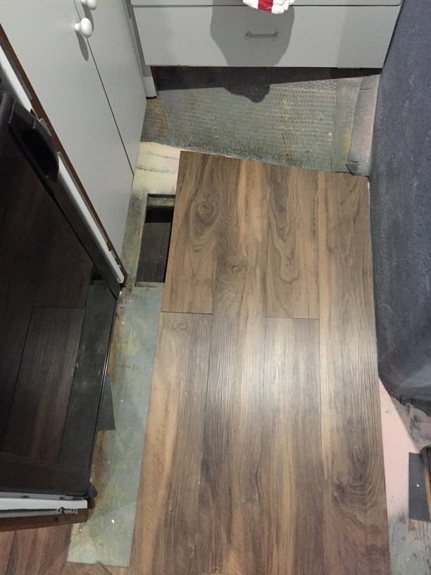

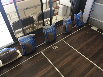

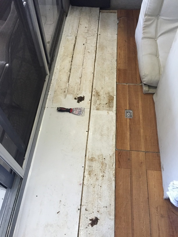

This past fall, I pulled all of that up and went with a thick "Luxury Vinyl" that glues down. I'm an architectural designer and put this stuff in new very expensive custom homes all of the time, so thought I would give it a shot in my boat. I've been very happy with how it looks and how it's held up.
It's a little tedious to cut and fit, but very simple. I think that there are only 2 or 3 pieces that are complete stock planks that did not need a trim around something. Cutting this stuff is as simple as scoring the top with a single swipe of a razor blade, and snapping it off. I used tracing paper bent around corners that I could see through and a pencil to create templates for radius wall areas.
This flooring is about $2 a square foot to buy. Think I had maybe $450 in this in material.

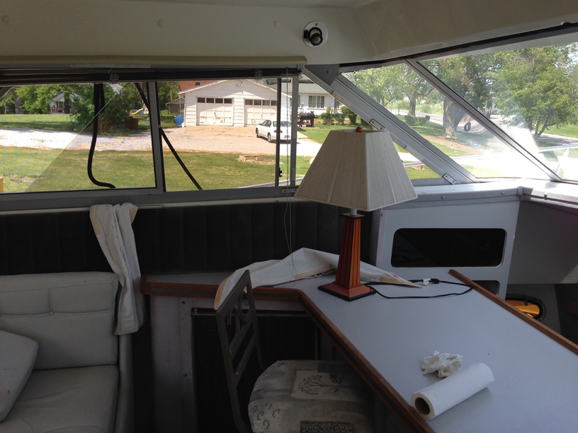

- As we found her..
- a1.jpg (136.96 KiB) Viewed 9341 times

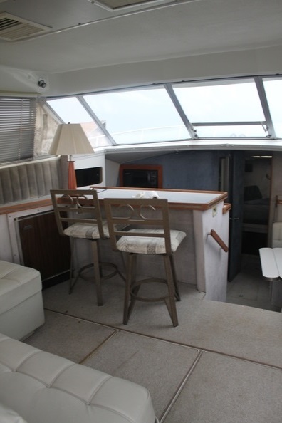

- Original (to us) interior pic
- b1.jpg (190.54 KiB) Viewed 9341 times
- c1.jpg (183.08 KiB) Viewed 9341 times

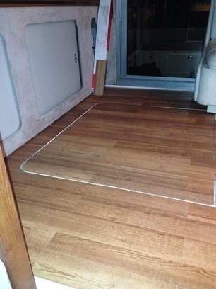

First stab at flooring. We lived with this cheap peel and stick stuff for a year in the upper salon, before deciding to start over.

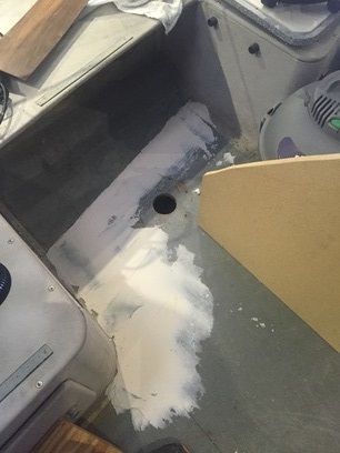

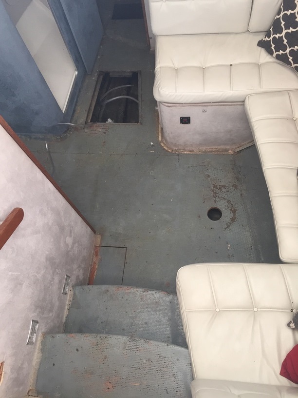

Old carpet up. Don't think Trojan planned on anything but carpet over their sole, so a little floor leveler was in order

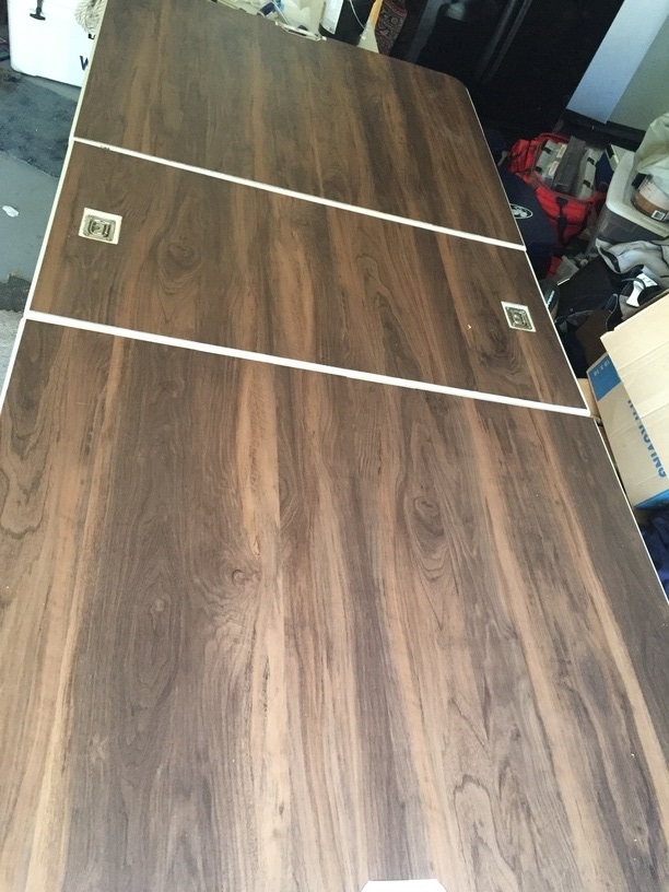

Originally made new hatches thinking that I would carpet the lower galley area and sized the hatches to for carpet to wrap around.
Got to make new larger hatches after deciding to vinyl the whole boat.
I brought my engine hatches home so that they could be done in the warmth and comfort of my garage. I taped the planks for each hatch together in a bundle and cut them on my miter saw, so that each would be exactly the same length and nice and uniform.
There is an uneven joint in the back of the salon in the sole. I didn't want to see this huge caulked joint in my floor, so went over it. I was having a hard time bending the thick vinyl over the joint and getting it to stick. My solution was a stick of conduit and sand bags to weight it down for the week to get it to conform to the weird bend. I now have a nice sandy beach under my slip...

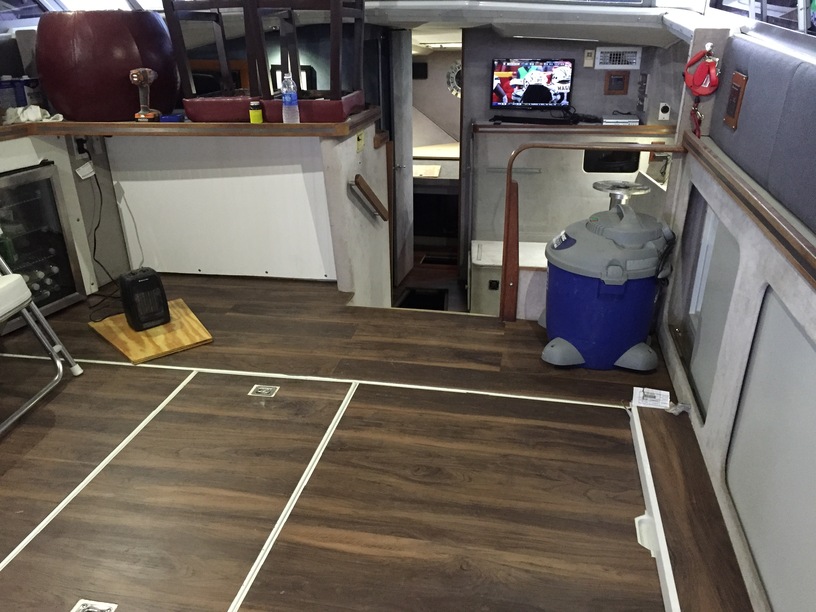

Re: 10 Meter Sedan Luxury! Vinyl Floor Project and general make over
Upper salon is coming together with a couple of space heaters and a little football on an off season cold day.

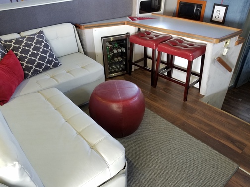

Couple of photos of the upper salon finally finished.
Original settee with a couple of cheap bar stools and an ottoman. The re-fabric'd side panels are curtains from Bed Bath and Beyond that match curtains we installed and had cut to length and hemmed by a local tailor shop. We used a piece of 1" bow rail and stanchions mounted upside down to the ceiling for a curtain rod.
That looks fantastic!
We need to remove the carpet in our boat due to my daughters' allergy problems and this looks like a better solution than what I have been thinking of. I have a few questions:
What did you trim the edges of the hatches with? I like the light color and it looks quite smooth.
Did you use a special marine glue or the same as you would glue it to sub-floor with?
How did you cut the corners? Did you use a jigsaw?
Any other tips? I am pretty sure this will be the direction we are going to take -- thanks for the idea!!!
Thank you! I feel like this is a good solution. We use our boat every weekend and have lots of friends come up. We wanted something relatively bullet proof that you could spill a cocktail on, a juice box or a plate of food and easily clean up. I considered a sheet style teak and holly look vinyl, but wanted to replace smaller pieces if I ever needed to, should we get a tear or scuff. I couldn't afford the real deal.
The meter boats have a fiberglass floor in the upper salon. So that my floor was not exposed on the edges and possibly peel up when lifting hatches, I held it off of the edge about a 1/2 inch. I made that mistake on the cheap peel and stick floor trying to hide the hatches.
On the smaller bilge hatches in the Galley area where the sole is plywood, I cut new 3/4" plywood hatches and covered them to the edge with a pretty tight tolerance.
The glue for this stuff is a compression type glue that you allow to sit up or become tacky like a contact cement. It goes on wet, and then becomes more like an adhesive on tape. The idea being, that a plank could be pulled back up. It takes about 3 hours to sit up in normal weather. Doing this in the middle of winter required some space heaters. This time of year, should be a breeze.
I used trace paper (sometimes called "onion skin" to trace over odd areas and radius' and then cut it out to transfer as a template to the flooring.
A fine tooth jig saw blade is definitely the way to go in these spots. Straight cuts, are an easy score and snap using a box blade and framing square.
