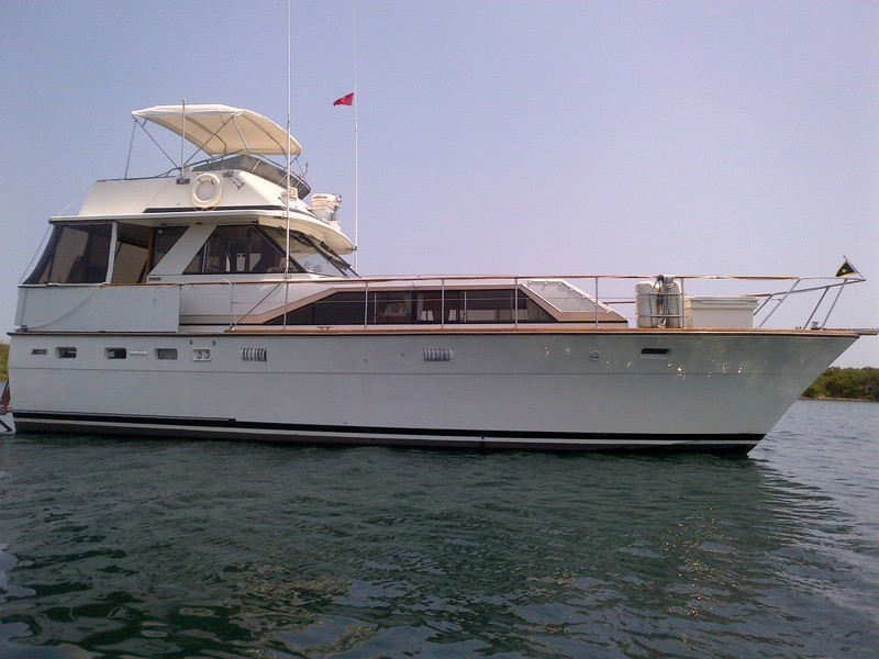

Re: F44 (or any other Crusairs) A/C condensate leak
I just looked at this picture and...... below the main salon windows......
- the upper drain must be the vent for the generator fuel tank
- the lower forward drain must be the galley sink
- the little drain just above the waterline (just aft of the generator drain) must be the condensate drain
Thanks again.
Ron
Thanks again.
Ron
