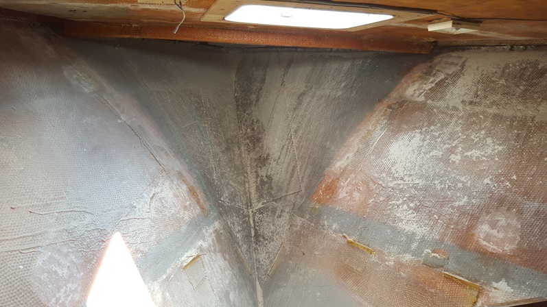

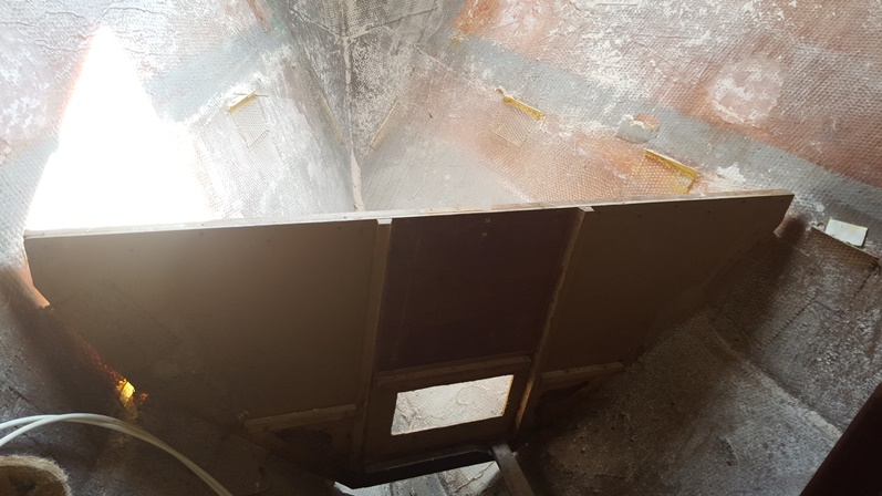

Christian wrote:I'm on "vacation" this week. So I can work on the boat. My sweet Better Half could not join me so I can make a mess as much as I want :lol:
Today I continued stripping the V-Berth. I got rid of the chain locker bulkhead. parts are flying out of the boat now :shock:
I have a few observations. What I found is household electrical wiring to the v-berth heater. (I half expected Knob-and-tube) LOL and the heater is not explosion (ignition) proof. Is this normal? I would have expected better from Trojan! Oh well. I'll have to fix this as well...

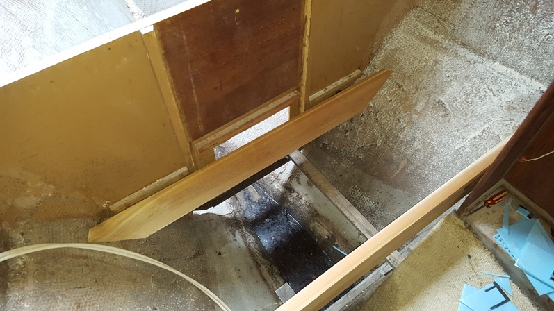

I spent more time at the boat over the weekend. V-Berth is progressing well although a bit slow. I finished cleaning the area and kept 1 bulkhead temporarily. I was concerned of structural integrity if I removed everything in one shot.

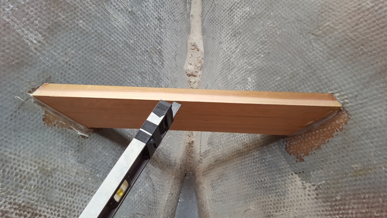

I then started adding ne floor joists.

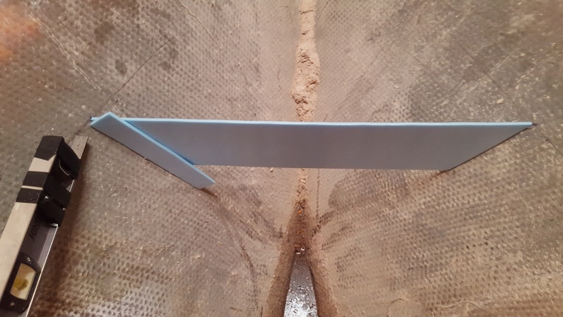

here, you can see how I made the patterns for the joists.
Of course I had to make 2 for each joist 1-1/2 inch apart so I could accurately cut the wood to match the hull curves and angles.
I have 1 joist left to put in but unfortunately, I ran out of time...
The next step is to put the tabbing and the plywood over the joists and build the bed frame. That's going to be in 2 weeks... Ill keep posting progress.
